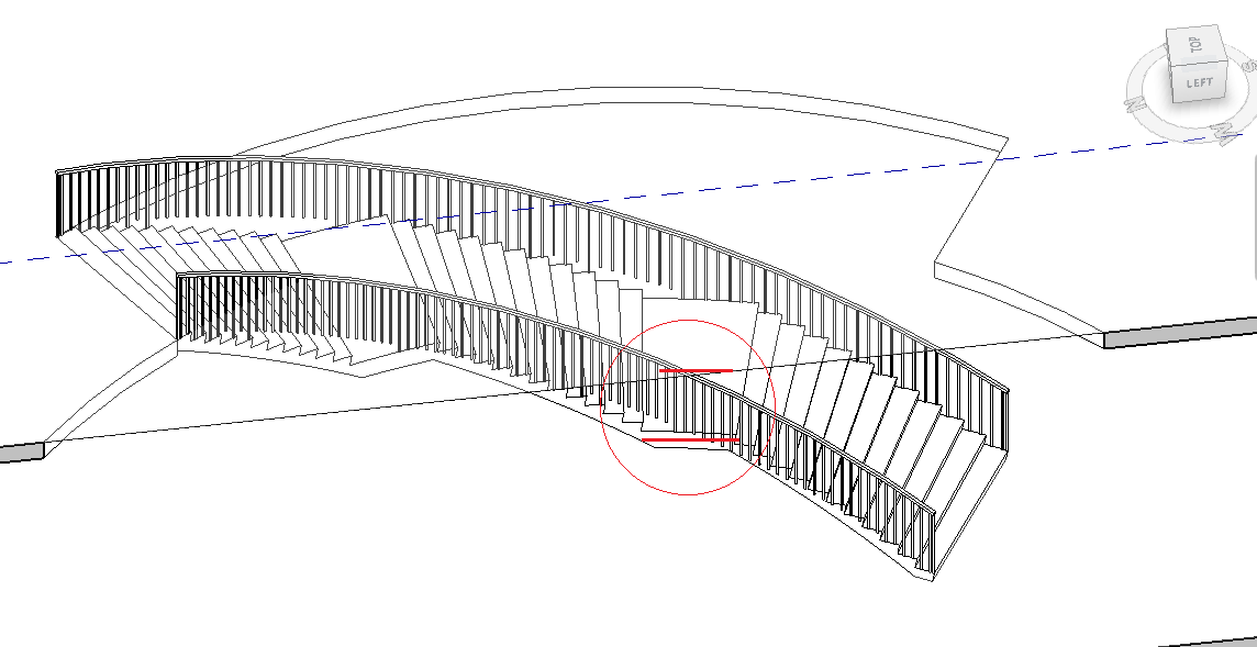

I'm currently drawing stairs for a project, but can't seem to make the railings match.
The stairs have been created using "Stair by Sketch". To get my platforms I stretched a step to the width of four steps. That was done twice. However, the railings don't follow the curvature of the extended steps/platforms.
I added a picture to illustrate the issue.
If you know of an easier way to make this, please let me know.
Thanks in advance.

Brake the railing sketch line at the landings.
