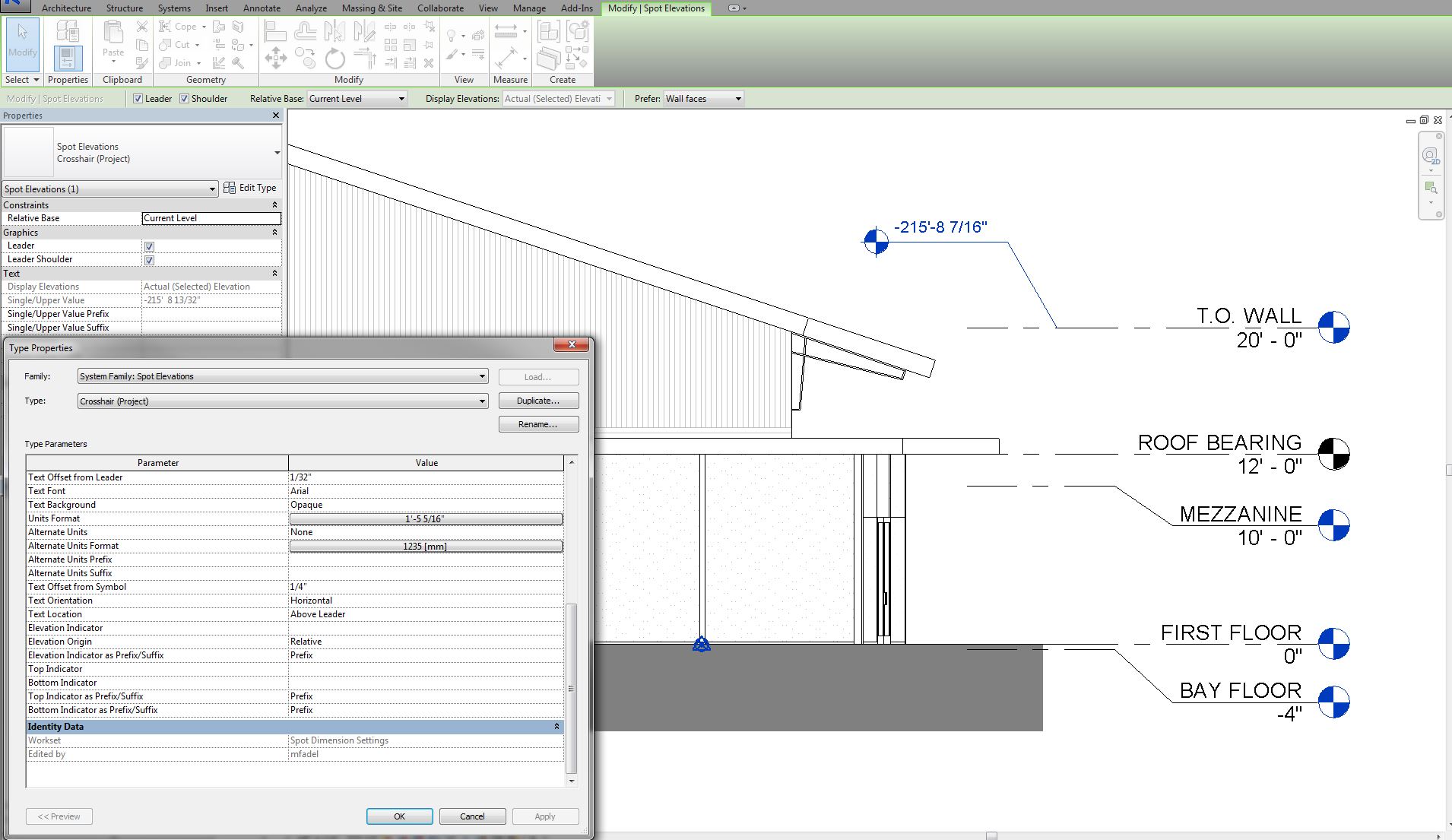

I am trying to understand why my project seems to be listed at approximately -200' below 0, when my project and survey points have both been set to 0'-0"?  The question came when I began creating a toposurface with absolute elevation at 0'-0" and I found it floating a couple-hundred feet above my building (in a 3D view).  I did not find some errant level way up in space either that would be allowing the spot elevation (with relative base point set to "current level") to be drawing information from elsewhere.  Any suggestion of where to adjust this -200ish elevation so that the first floor level is truly at 0'-0" would be appreciated.  Thank you!

NOTE:   Your spot elevation is set to relative to the current level.  We don't know what you have as the current elevation ... A building Elevation view has no associated level.  So change that from relative to project base point.
If you can, always try to create your topo from an imported survey or points file.  When you create a topo by placing points, the default 0 is relative to your base level.  Not really your survey or your project base point.  So point elevations entered here are almost meaningless.  Especially if you later use the relocate project.

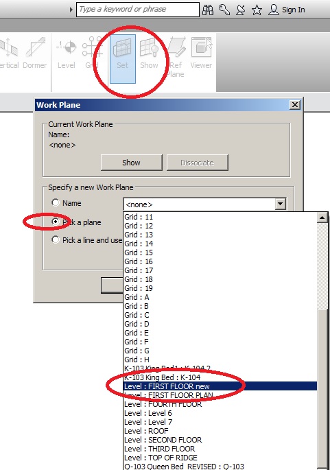

Work planes can be set in any view from the architecture tab / set "ref plane".

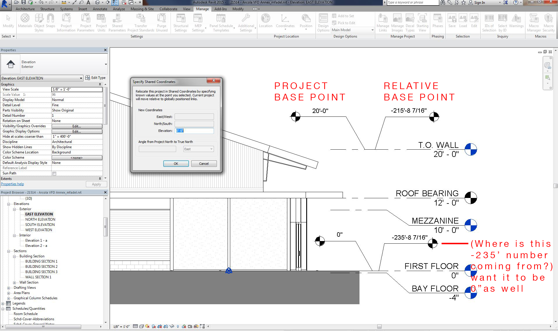

I suppose I'm not making myself explicitly clear.  I acknowledged that I can change the tag to get the correct reading on my elevations.  What I want to fix is some errant elevation of ~ -200' that is somewhere in the project.  This will allow me to create a topo surface with points (a simple exercise) without having to do a lot of unneccesary calculations whenever I want to adjust the topo around my building.  To put simply, where is the -235' coming from and how to I change it to 0"?

Let me say this again.... YOU ARE THE ONE THAT SET'S THE WORK PLANE FOR AN ELEVATION VIEW!   I don't, Revit doesn't.  So do that.   Set the work plane to your ground floor in that elevation view.  Now your relative spot elevation will be correct.

Can you verify from a Site Plan view what your Project Base Point and survey Point display when you select them? I would agree that it is difficult to understand what your spot elevations are in reference to in those views. Is it just the topo or are there other object there that may be showing up in that view?
