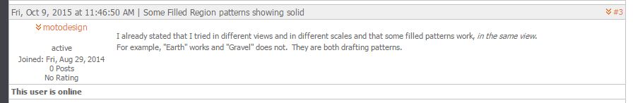

Fri, Oct 9, 2015 at 1:46:49 PM | Some Filled Region patterns showing solid
motodesign
Joined: Fri, Aug 29, 2014
0 Posts
I already stated that I tried in different views and in different scales and that some filled patterns work, in the same view.
For example, "Earth" works and "Gravel" does not.  They are both drafting patterns.

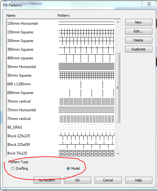

Go to the properties of that filled region and see if the hatch pattern is a "Model Pattern" of "Draft Pattern".
Like WWHub stated, draft paterns change with scale and model patterns don't.

Tue, Oct 13, 2015 at 1:59:02 PM | Some Filled Region patterns showing solid
Obviously, you have NOT read our posts!  This is NOT CAD.  Revit has drafting hatches and it has model hatches.   Please read this then come back if you have a new question.
Tue, Oct 13, 2015 at 2:10:57 PM | Some Filled Region patterns showing solid
#9
motodesign
0 Posts
Please see Post #3 and attached image.

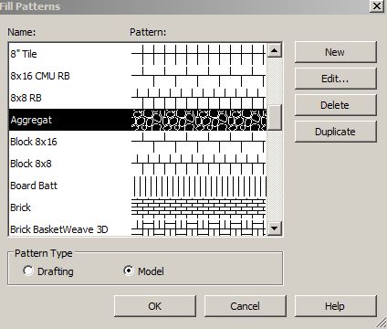

Tue, Oct 13, 2015 at 4:04:46 PM | Some Filled Region patterns showing solid
#11
moto - Show us a image clip of your model gravel pattern.  MODEL! Like the attached image.
