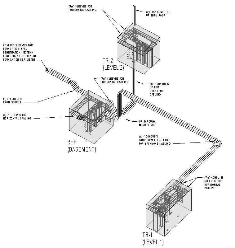

I like to use a 3D object which represents my Low Voltage Electrical Room so I can create a 3D riser diagram showing conduit connections between each room.  Also, I can shade in the room automatically in every plan view.  Right now I create an in-place Data Device family, and create an extrusion of the room, and give it a height of 8'-0".  I have the Architects model linked in.  Is there a better way to do this?  I would like to create a Family that can be imported into each project and adjusted.

One idea that comes to mind are some external plug-ins that we use in our office that can convert room objects to 3D masses. I found something similar from case (awesome resource by the way) that might inspire a solution for you:
http://apps.case-inc.com/content/subscription-extrude-rooms-3d-mass
