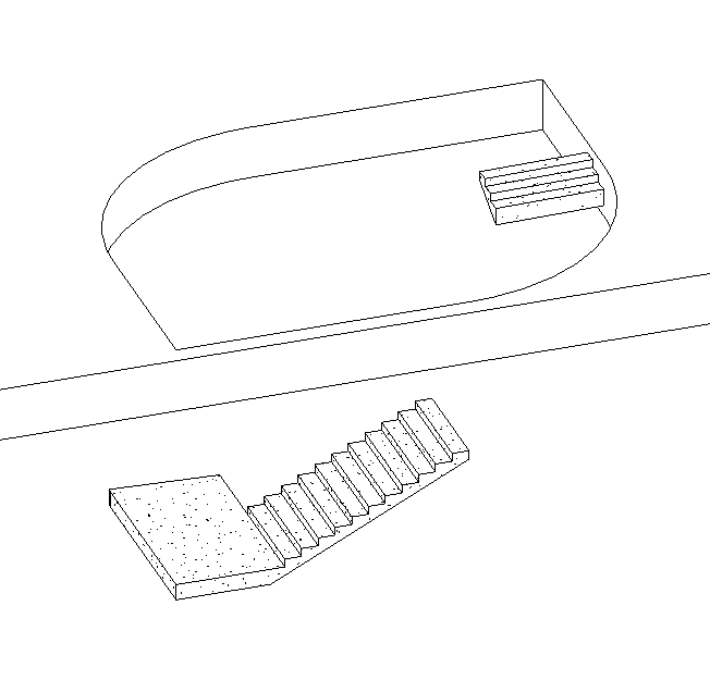

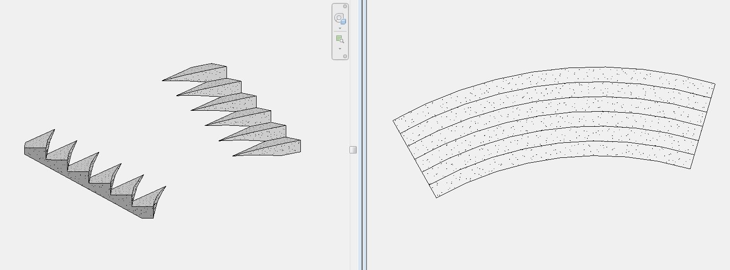

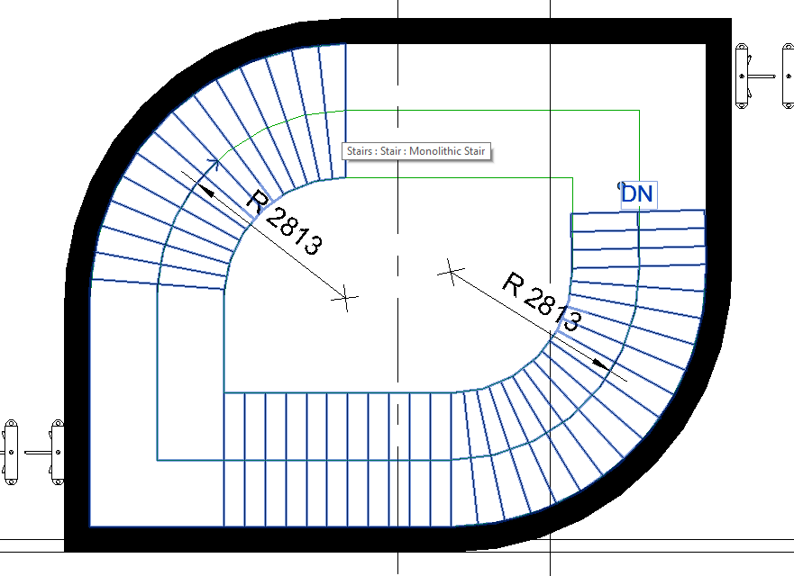

Hi!
Reit is not fully drawing 3d for my custom stairs.
Please see two attatched images. Why this is happening?

it actually looks like a bug.. when i change stairs to not-monolithic everything is fine..
please see attached file, rvt2015

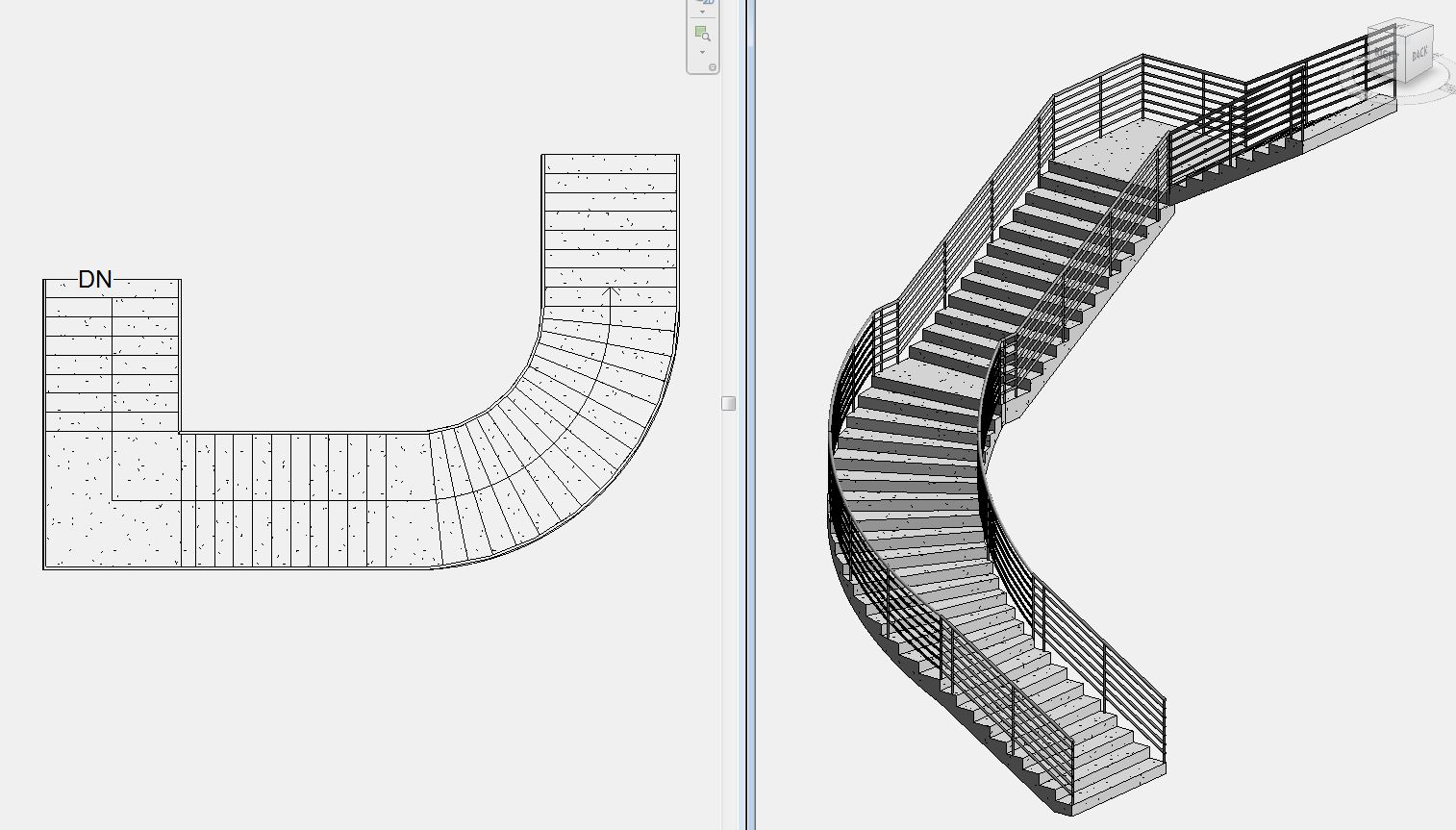

Revit always had a problem displaying 3D monolithic stair with curved risers and smooth underside (see pic 1). Your risers are straight with curved boundary, I’ve never seen that before.
Start with the component stair, turn it into sketch and edit the sketch to suit your needs – should work fine then (see pic 2).
