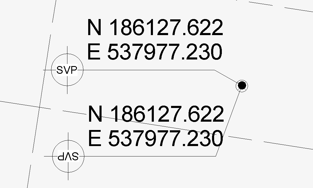

When I tag above it displays correct but when I take below the SVP the text changes to upside down, does anyone know how to fix this?

In the family, select text/label and check 'keep readable' in properties window.

That didn't work Sad

Are you mirroring that tag?

No I'm not mirroring, also why can't I pick to the centre point of the SVP ?
I've attached the family here.

See this.

Cheers !
