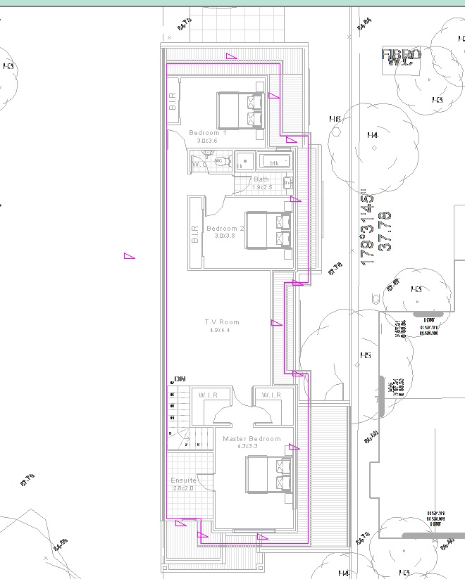

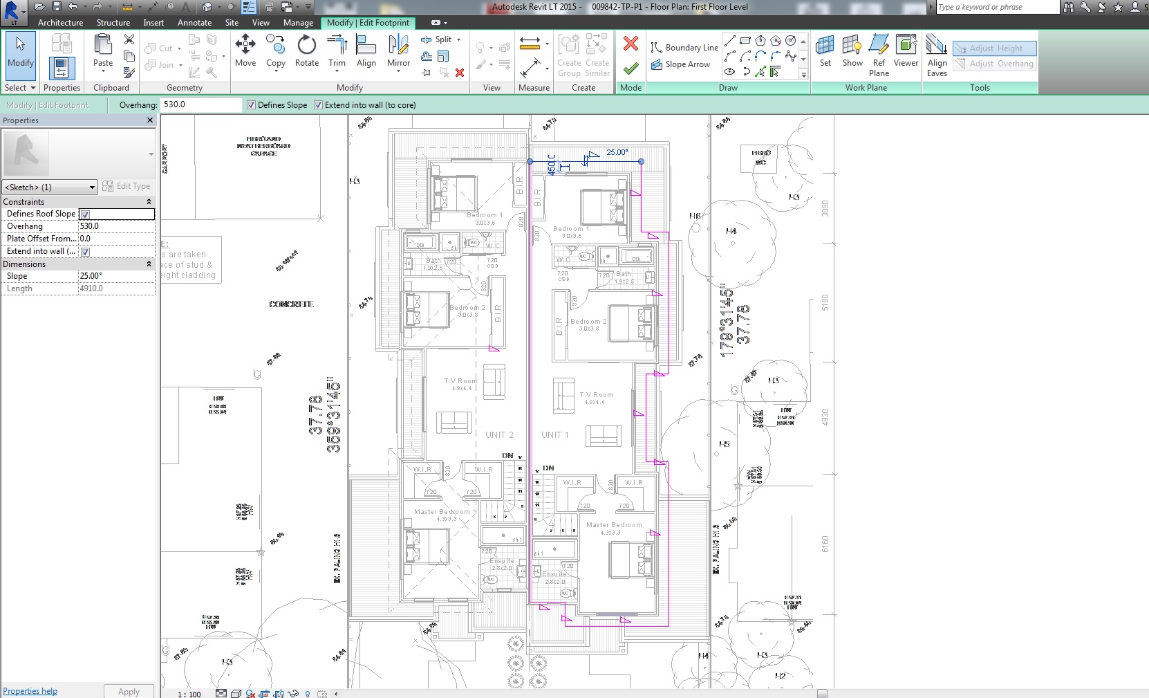

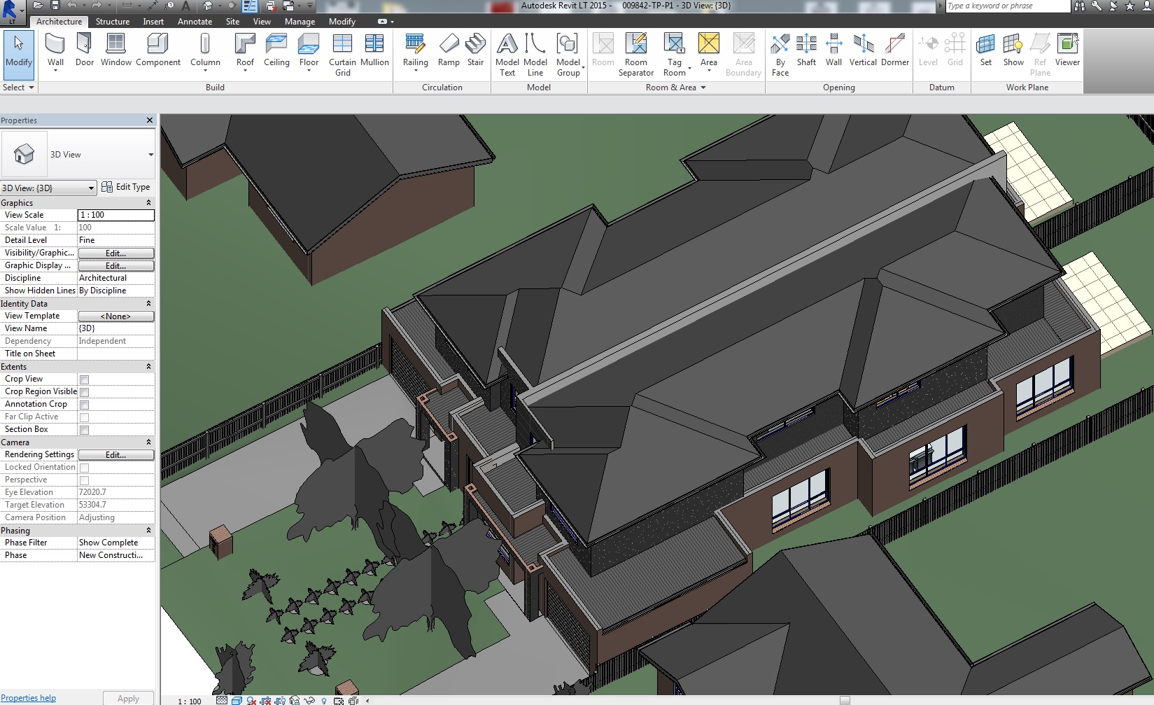

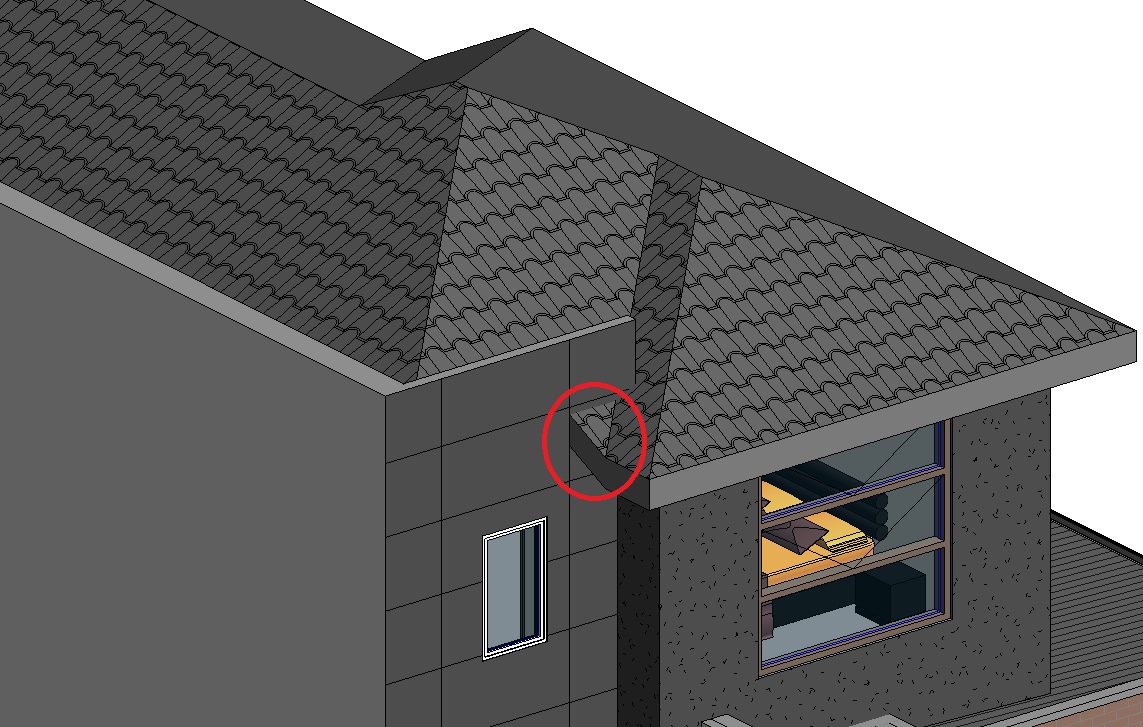

Hi guys,
Having problems with my roof. Trying to get the eave to go stright into the parapet wall. It keeps pitching up. See pics.
They are extended to wall core and selected via wall select tool.
If I just use the draw line tool and not extend to wall core it works although it pitches at wrong point at other end.
Revit 2018........

is it the overhang nominated for the roof over ensuite short wall perhaps?

I have no Over hang there but need 450mm overhang to then tie into the ensuite wall. Just not playing nice...

try this, see attached.

still pitching weird not sure. Thanks for help guess just mask it for now....

post your plan with roof and i will have a go at fixing.

i meant a rvt file, but no problem , see my attachment , click on roof, click on edit footprint and have a look at the area of concern,
and which bits have no slope attached or core disabled.
