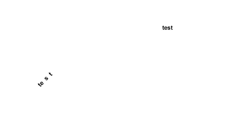

Has anyone encountered this?  I have text that when I put it on an angle it gets jumbled up but looks fine when horizontal or vertical.  I tried with different text styles and get the same result.  It looks fine on my screen but looks like the attached image when I create a PDF and when I print it.  The really weird part is that it only does it on text sizes 3/16" and smaller??

Try a different PDF writer.
Wed, Sep 30, 2015 at 4:10:46 PM | Text at 45 degree not right in PDF
Are you printing your PDF at one scale and actually plotting that at a smaller scale?

They are at the same scale.  I will have to try a different PDF writer.
