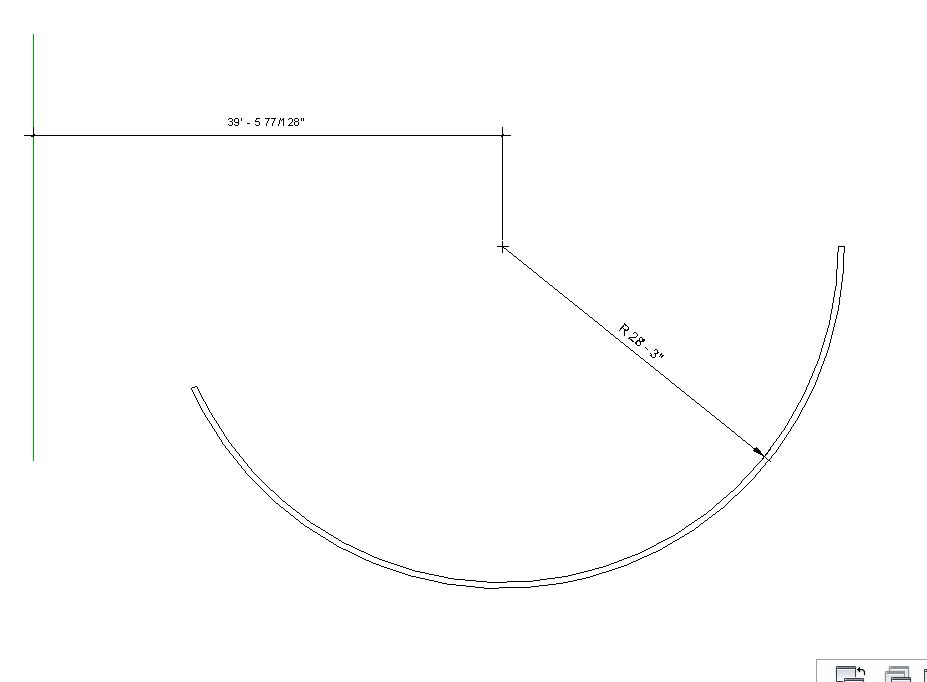

I am curious as to how people are dimensioning to a center mark of an arc i.e. I have an arced wall and I have a radial dimension for that wall shown. I would like to show a dimension string that references that center mark of the radial dimension to another known location. it doesnt seem as though you can dimension to that dimension center point, correct me if I am wrong.

Do you mean like the attached?

yes I believe so.
Tue, Sep 29, 2015 at 7:47:56 AM | dimensioning to a center mark of an arc
Just turn on the center mark for the wall - not the radius.........

Is it possible to dimension the center of a radial dimension.  Can't seem to do it even with the center mark of the radial dimension turned on.  How does everyone else do it?  We have some floor patterns with arc's in the transitions of materials and need to locate the radius of the arch.
Mon, Jul 19, 2021 at 6:24:57 PM | dimensioning to a center mark of an arc
As far as I know, You will still have to add linework at the center to dimension  to.
