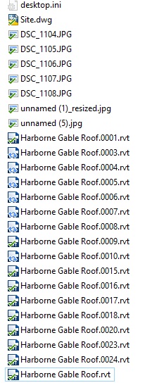

Hey guys,
I have just been saving my work onto google drive. I am trying to save space. Revit is having multiple backup files (like 6)
Where is the option to tell it I only want like 1 or 2?
Thanks.
Revit 2018........

this is after I had already deleted like 10 files...

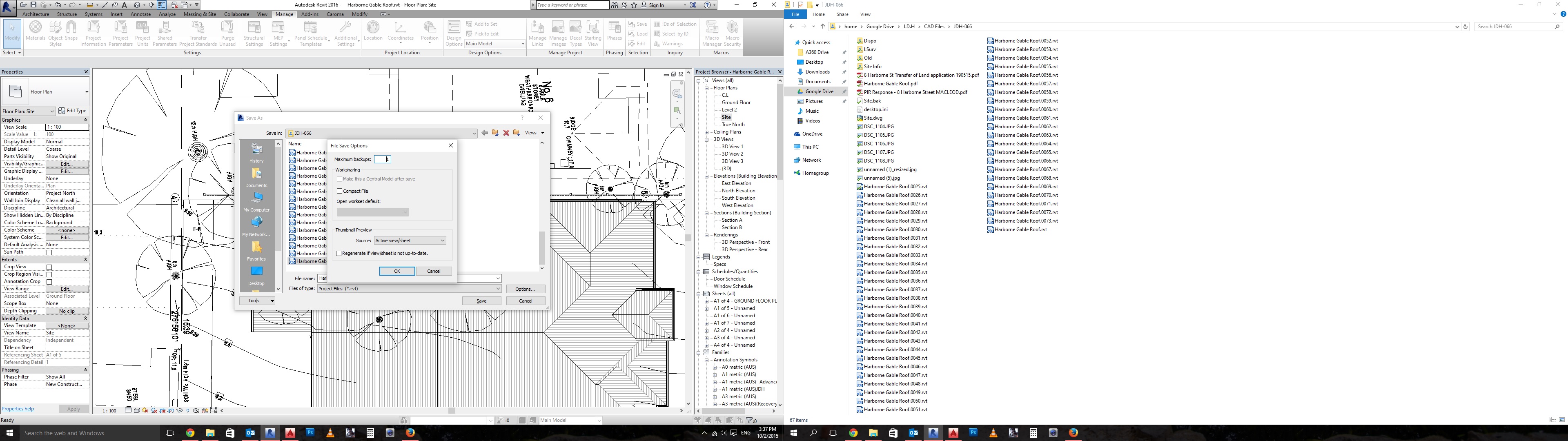

In the ‘save as” or ‘save’ (if saving first time) window, choose ‘options…’ and adjust ‘maximum backups’ option.

I can do it when I do save as. Cant find it in the options from the R drop down though.

My back up files were set to 1. I still get this....

anyone know why this happening?
