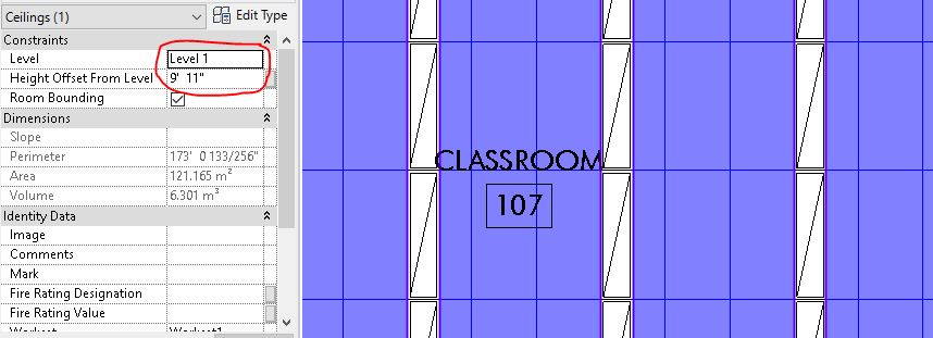

I am in Revit 2021, I used the elevation at bottom. It is giving me the height from first floor not the level the ceiling is on. Any suggestions?

Make sure the ceiling is set to the correct floor level and then ensure the tag is using the "Height Offset from Level Parameter" for the label within the tag family.

Thanks but we are speaking of the bottom of a floor ceiling assembly, not a "ceiling"...

You are not telling us much.  First you say "... the level the ceiling is on"  now you say "...not a "ceiling".
We are architects and we should communicate better than that.
From what I have read, I am going to guess and ask "Do you just have an exposed structure and not a ceiling?"
If that is the case, Revit has always had a solution.  You can put a ceiling in to host your lights and other ceiling mounted elements but that ceiling has no properties.  It is in essance, just a plane and that cn be tagged with a height.
