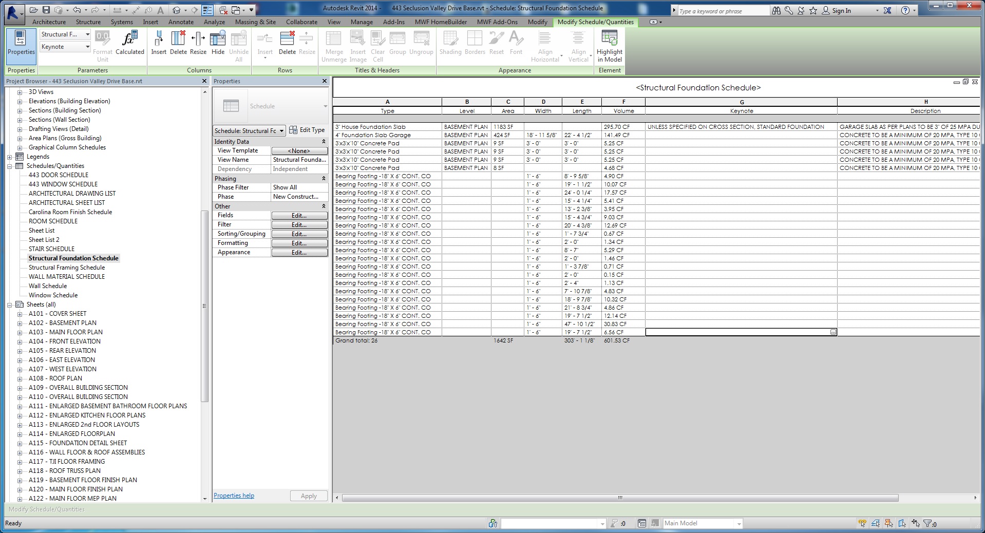

How can I quantify an element within a schedule to only show one of a series instead of every instance. See attached. I want the schedule to read only one bearing footing style in type and show over all lineal feet or cubic meters instead of each instance

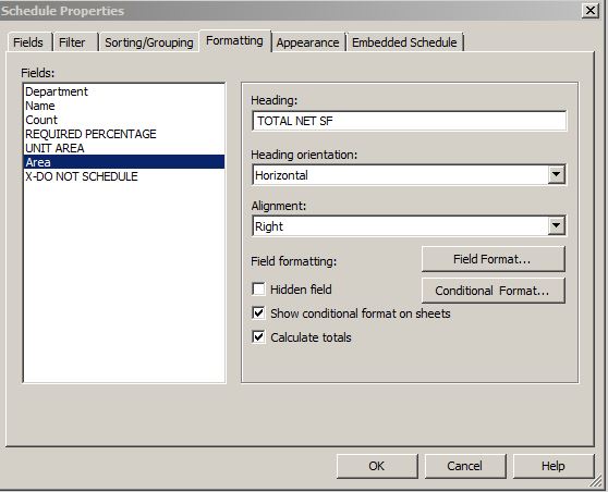

Sort by type, uncheck itemize every instance and for your length column, check the Calculate Totals like I did on the attached image for an area column.
