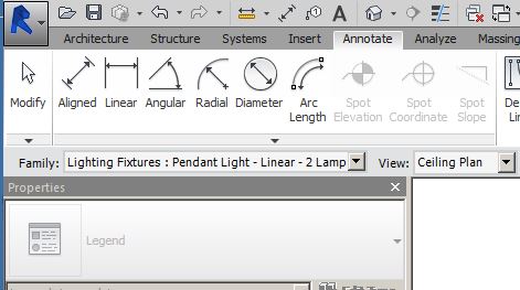

Is there a way to show light fittings in a RCP legend as they appear in a RCP view? i.e. viewed from below.
The legend shows the light viewed from above whereas the RCP shows the light fitting viewed from below, so they don't look the same. Confusing for anyone trying to read the legend!

Mon, Sep 14, 2015 at 8:36:29 AM | Light Fittings in Legend
Set your legend component view correctly.

That view direction isn't available for the lighting components. Only floor plan and elevation front and back is available. How do I add the choice for a ceiling view?
These are Philips light fittings downloaded from their website.

Mon, Sep 14, 2015 at 11:12:37 AM | Light Fittings in Legend
As you can see from my image, that view IS AVAILABLE for lighting components unless maybe they were built wrong.  Post one of the families you are using - maybe we can make some recommendations.

Tue, Sep 15, 2015 at 10:02:23 AM | Light Fittings in Legend
That family was not built to Revit conventions for a ceiling light and it is poorly done.  It does not work correctly to cut the host ceiling and component visibility is not set correctly.
