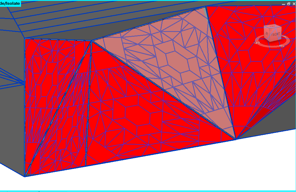

Is it possible to create super-custom curtain wall grid?
Please see attached image.
As far as I am now, I can make custom triangle curtain wall faces, but grids are  only vertical or horizontal..
Maybe I have to use other approach? not curtain wall..

You can't change the angles of the curtain grids but you can create the triangular shaped panes individually if you edit the curtain wall profile then you can add mullions to the edges. This would mean you need to draw quite a few triangular planes to achieve this but that's the only way around it I can think of.
Hope it helps
