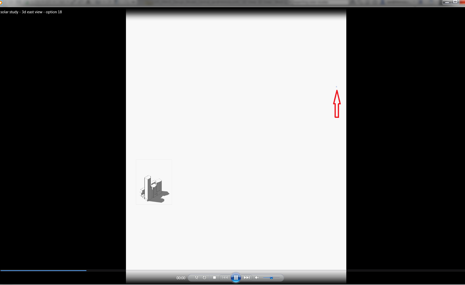

When I export a Solar Study it appears larger or smaller depending on the view.
Some of the 3D Views I have created solar studies for, export as a full screen image/videos.
Others I have exported are too small and unwatchable. After a few trials, I noticed it seems to include the orgin point. See screenshot attached.
Is there any way around this?
They work fine on screen, but in terms of showing a client or non revit user, I need to export the animation.
Revit 2015 user.
Kylie

It's all part of the size of the viewport / crop region and the options as you export the AVI.

I created crop regions as I only want to animate a certain section of the site.
I couldn't find anything in the export settings that solves this problem. Can you specify what I should be selecting at export?
I have tried zoom to 100% and zoom to 20%. The animation remained the same size in the video, in both exports.
The animation works on screen as you can zoom to the area and press play, but when I export the animation I get the small image as shown in the screenshot I attached in my previous post.
It looks like the video wants to include the orgin point when you export, which reduces the size of the image you want to animate. Is it possible to turn the origin point off in animation exports?
Any help would be appreciated!

I'll have to test it out. I'm pretty sure there's a way to properly size the exported AVI.

The answer is simple...
Open the view, select the origin point, and hide in view.
When you export the animation it appears in full screen.
