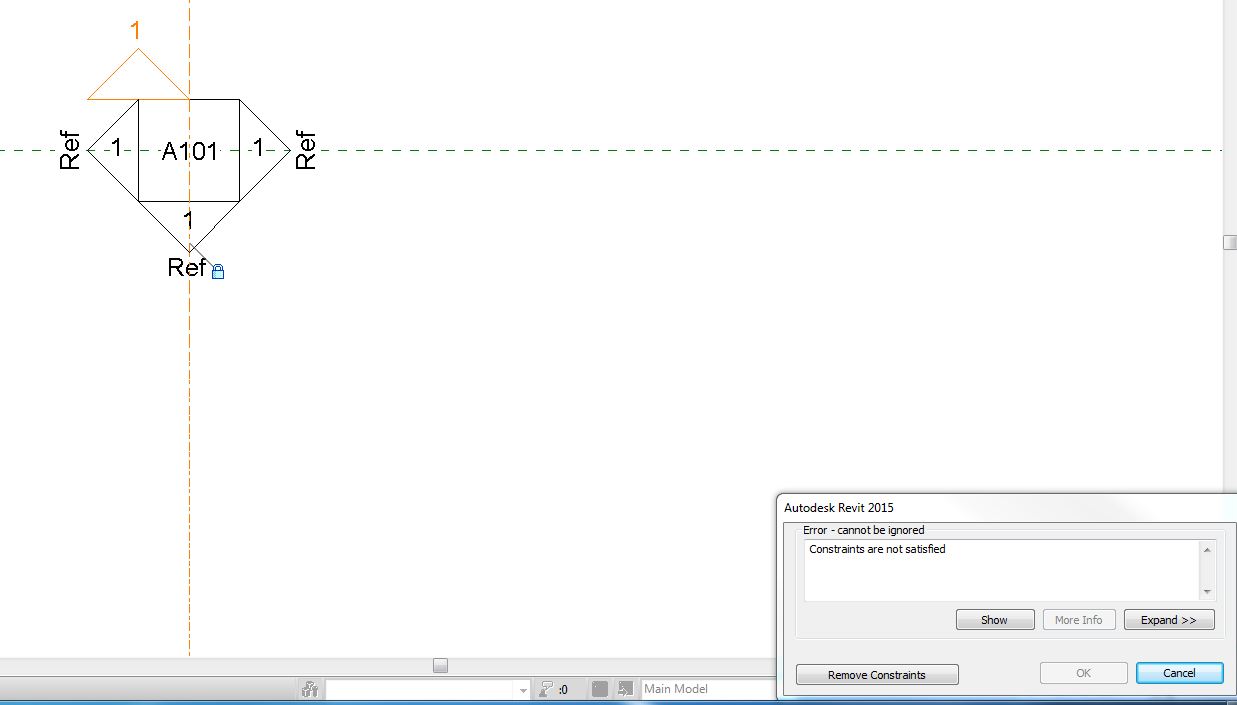

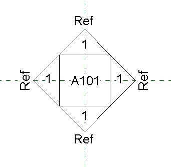

Hello All,  I am editing an Elevation tag to add more text. I opened up the head callout family copied one of the labels and gave it a viability parameter and made a family type. When I load it into the elevation mark family and change the family type it moves the family breaking the constant. Anyone have this problem or know whats going on?  I loaded two images and the file if you wanted to take a look. If you are in the file change the head to "Detail Number outside Justified T/B" and you will see the problem.
Revit 15
Thanks,

I seem to have fixed it by deleting that top nested family and added it back again but didn't align and lock it and it works fine.
I don't think there is any need to 'lock' any of the alignments. Just place them and leave them there.
