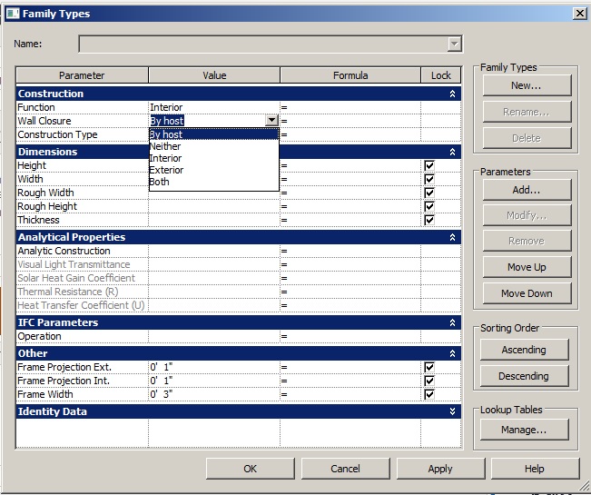

I recently created a door family with jambs and in a plan view the wall layers do not wrap even though the wrapping layer is checked. there is something I did or didnt do when building the family and I can figure it out.
I am attaching a revit file that has the door family with jambs and an OOTB door that does have the wall wrap at inserts.

Does this explain your problem?  Family properties.

apparently I did not have check when I thought it was. sorry for wasting everyones time

apparently I didnt have the "wrapping at inserts" checked when I thought it was. sorry for wasting everyones time.
