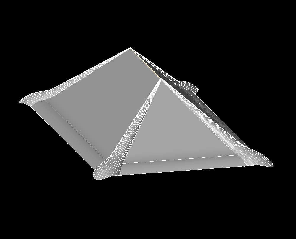

Hi Mr Spot, Can arcs be used and constrained in a sweep revolve? I am finding that I can create a revolve in what ever shape however, when the axis is adjusted to a desired angle the arcs have a mind of their own. What I am trying to do is create the corner detail I showed in a recent thread, which is quite an organinc shape but without the radial lines. See attached. The shape you see has been successfully created using a segmented sweep however, each aris of the segments are visible. Creating a sweep revolve removes the radial lines but I loose in functionality. Any suggestions? cadjockey
Wed, Mar 29, 2006 at 2:46:10 AM | RE: Revolve Axis
cadjockey
Joined: Thu, Jul 28, 2005
208 Posts
No Problem. I solved it. cadjockey
