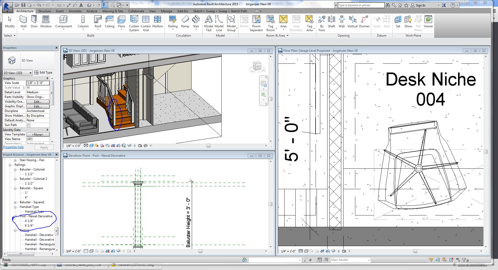

I downloaded this newel post and loaded it into my project, but I can't get it into the railing structure for picking an end or corner post.
I've set the family to Railings as you can see in the family tree, what am I doing wrong?

Try it as a baluster
