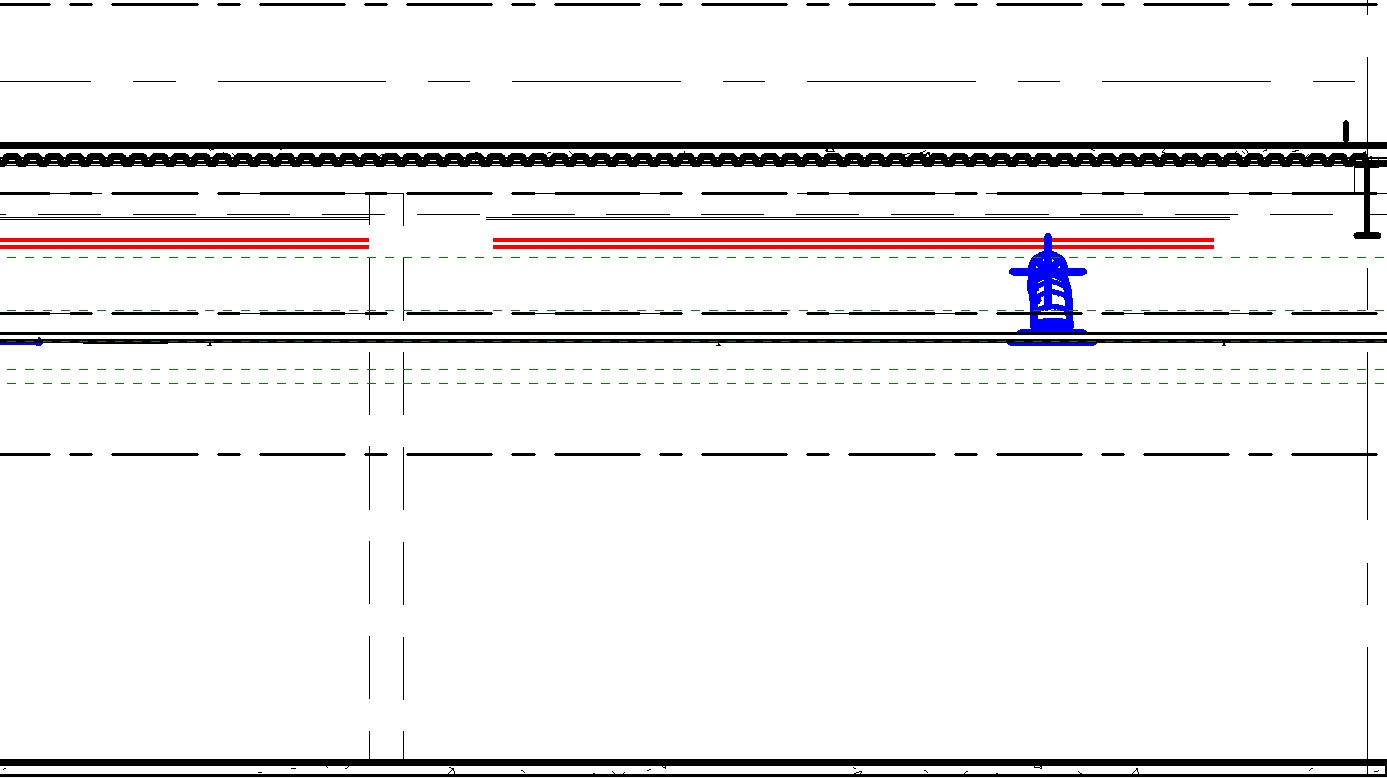

Hello,
I am working in a PME file (Revit 2014) with a linked architectural file.  There are certain small areas where somthing is causing part (only part) of a pip to become invisible, however the rest of the pip on either side is still visible.  There is just a few foot segment in the middle of one continuous pipe that is not visible.  It almost looks like a masking region or somthing else is coverigng it, but I have gone as far as even looking in the architectural model to see if I can find somthing there, but there's nothing
If anyone has any ideas on somthing that can cause partial visibility of elements due to somthing in a linked file, it would be greatly appreciated.  I have been working in revit for over 3 years now, and i can officially say, I'm Stumped!!
-Jennifer

it almost looks like the pipe system has a dashed line and your scale is set such that the dashes are really long as a result of that ?
What happens when you change the detail level of the view and or the scale of the view ?
Of the pipes take a bend in plan and the section far clicp plane isn't deep enough to see them in the distance.
