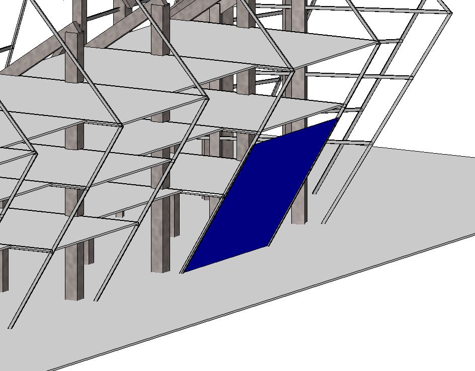

I'm creating a desgin stadium, and I need to create and control a serie of facade panel in difference color (material dosnt matter, just design).
The panel's are in a angle and some in top of each other.
I tried create In-Place Mass, but I just can't control it. I got lucky and create one of them, that is sort of in the right place, and angle. But I can't edit the wall, or control it.
Can anyone help.
Sun, Aug 23, 2015 at 1:41:46 PM | Creating and controling facade panels
You have to edit the mass if you want to change it.   A mass is probably your worst option.   In this case, look into an adaptive component
