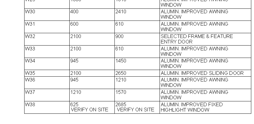

Hey guys is there anyway I can overridge a size with text?
I have a abnormal size window and just want to put verify on site rather than a size.
Ive had to make a legend and put over the top on the sheet. Would like to remove the dimensions as the window is triangle and it only has 2 dimensions.
Thanks.

A bim type answer would be to modify your schedule adding a conditional family that would control a new size field.
The easy anser but hard to manage is to add opaque text in paper space - not a legend.

Thanks heaps WW!
I know its a work around which usually I dont like. Although since its a one off worked a treat.
Thanks again.
