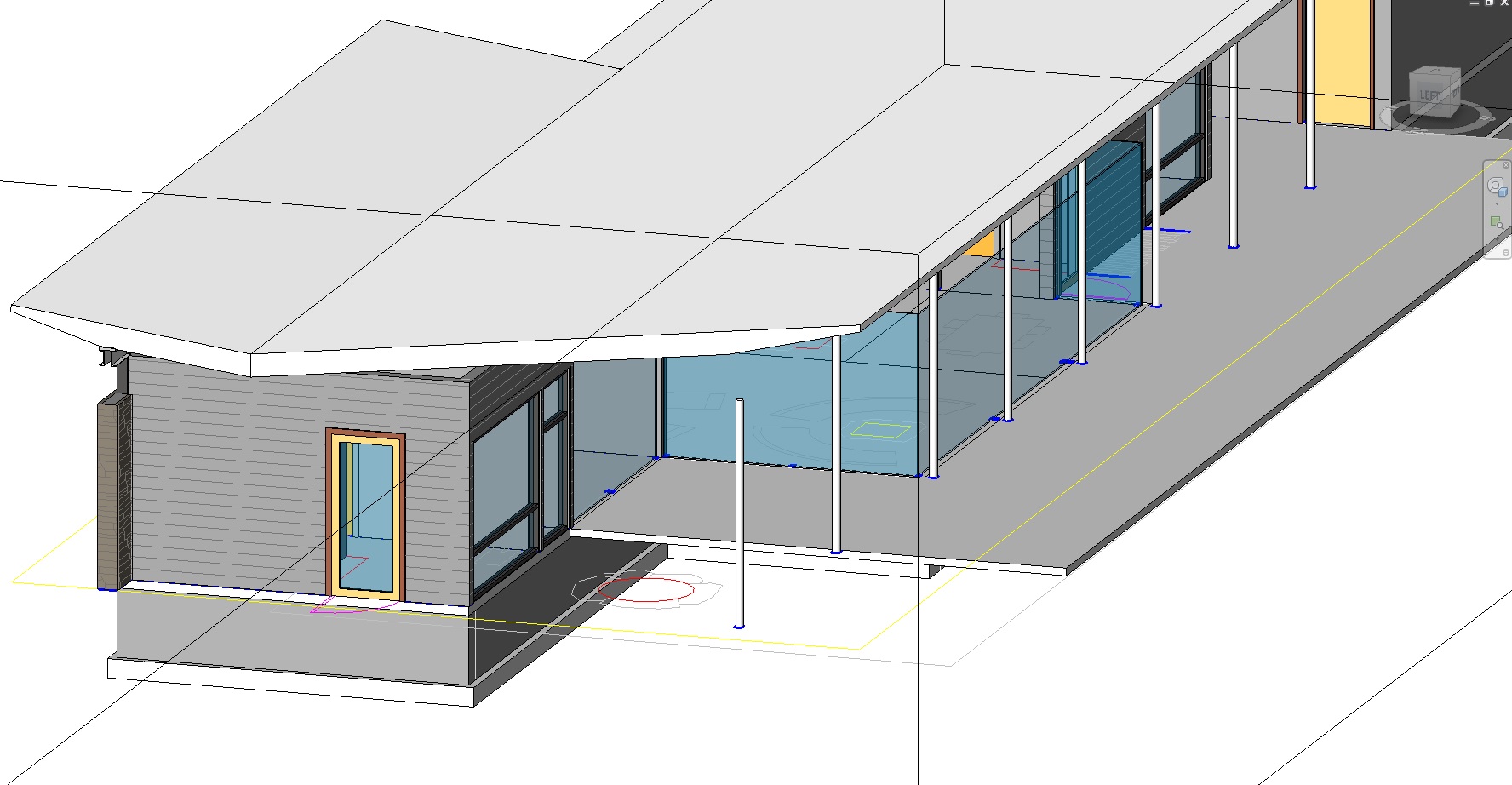

Hello,
I have created a few mass roofs in my project to achieve a custom roof profile in Revit 2015.  Crying See attached image.)  I started by creating a mass in model and then converted it into a solid mass roof.  However I cannot select the roofs when I go to attach my walls with the "Attach Top/Base" command.  Any idea how to do this?
Thanks,
Megan
Edited on: Tue, Aug 18, 2015 at 11:37:41 AM
Tue, Aug 18, 2015 at 11:18:17 AM | How to attach top/base - walls to mass roof
If you had used the standard model in-place tools and assigned the family to roof category, then the attach tool works.
Tue, Aug 18, 2015 at 11:29:49 AM | How to attach top/base - walls to mass roof
DurangoArchiChick
Joined: Tue, Oct 11, 2011
19 Posts
Maybe I didn't assign it as a roof properly.  I assigned it in the properties dialogue box when I clicked "Edit in Place" in the Modify Tab.  This was after I already built the mass.  It was originally defaulted as a floor.
Tue, Aug 18, 2015 at 11:33:16 AM | How to attach top/base - walls to mass roof
DurangoArchiChick
19 Posts
How should I have done it?
Edited on: Tue, Aug 18, 2015 at 5:43:33 PM
Tue, Aug 18, 2015 at 1:12:48 PM | How to attach top/base - walls to mass roof
I rarely ever use a mass except in the conceptual enviroment.  So I don't know what problems occur with switching.
I simply start the model-in-place process and set my category first.  I know that works in this instance because I tested it to make sure.
Tue, Sep 22, 2015 at 2:23:43 PM | How to attach top/base - walls to mass roof
DurangoArchiChick
19 Posts
How do you set the category?  Are you using the "in place mass" tool?  I can't seem to make it a roof and not the default floor.
Tue, Sep 22, 2015 at 3:18:05 PM | How to attach top/base - walls to mass roof
When you start a model-in-place family, the family category interface pops up automatically.
