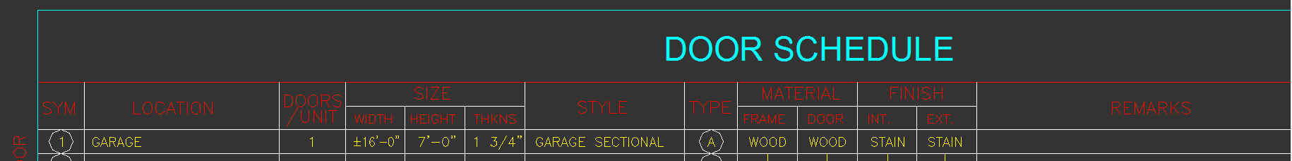

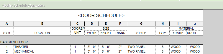

I am recreating my offices door and window schedule in revit 2015 and I am just about there but I am having an issue with scheduling the finishes. The frame material is a pre determined field in revit so that was easy. Our doors and frames are always the same material so I made a calculated value for that no problem. But where I run into an issue is getting independent interior and exterior door finishes. I am fine with having to enter the information manually in the schedule, but I can't figure it out. I have attached our CAD version so you can see what I am going for and also what I have so far. Any suggestions would be helpful. Thank you!

You can add shared parameters to your project (AND TEMPLATE) for this data or it can simply be an added schedule parameter.

Thank you! I got it working with your solution.
