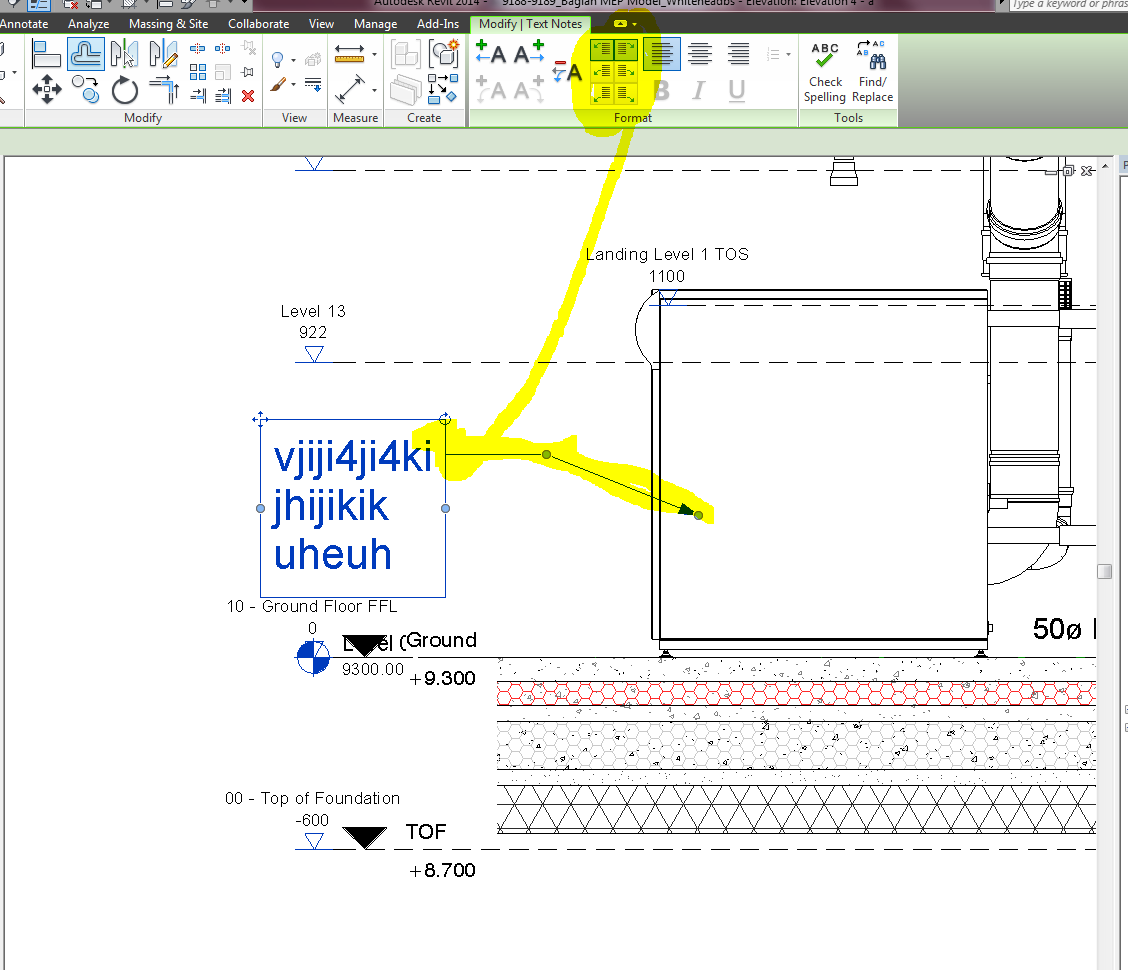

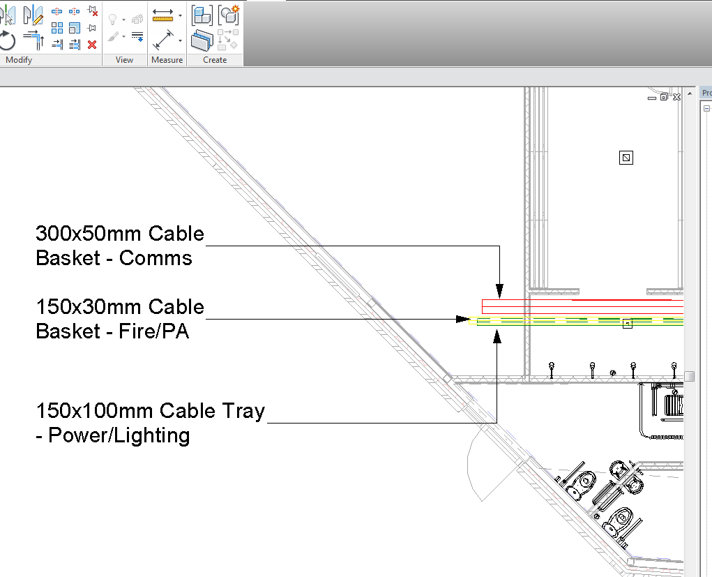

Hi all,
How can i edit the origin position of my leader when tagging, like you can when applying a leader to text?
I want my leader to be adjacent with the top line of my containment tag, not in the centre.
Please see images.
Cheers
Andy
Thu, Aug 6, 2015 at 12:16:39 PM | Positioning the leader on a tag.
This has been an issue for years.  Tag leaders come from the 'center' of the tag on all 4 sides.  You can control this somewhat by adding reference planes in the tag family.   I don't believe you will find a way to get it to come from the top line.
