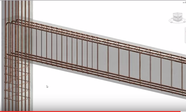

hi guys , i have revit 2016 and rebar is shown as a singlr solid line and i want to show it as this pic or double line

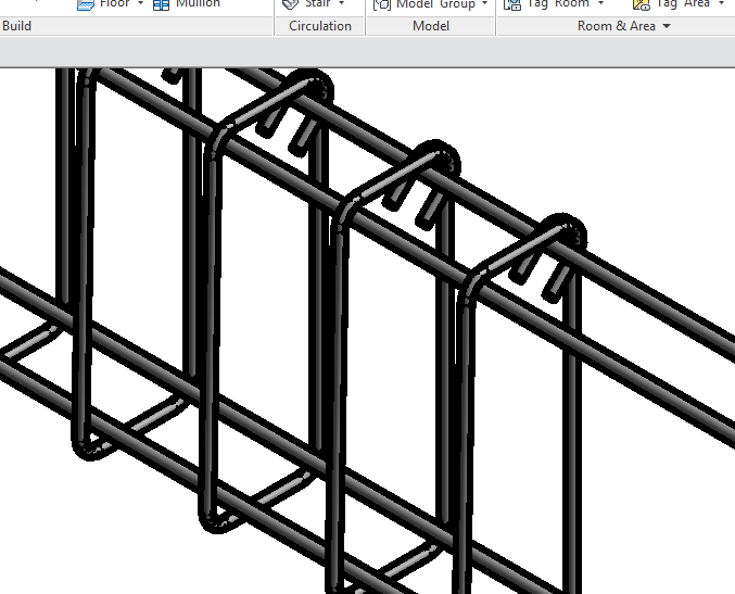

thanks sir but it has a black strock can i hide it ?

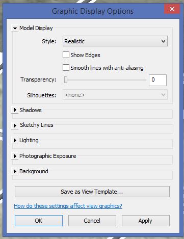

YES YOU CAN HIDE IT.
in your 3d view, go the properties browser
- click to GRAPHIC DISPLAY OPTIONS
- AT THE DIALOG BOX, CHECK 'SHOW EDGE', (see attached picture), then the black line will be hidden

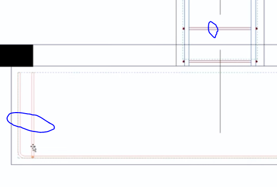

i have another question please
i sections i want to display the rebar as a Double Line as the pic
how can i sir ?

Hi,
you can make it just by checking your detail line level.
- click to the detail line level button locate at the bottom ( as shown by the attatched picture)-
 then select 'FINE'
Hope thats hepls you
