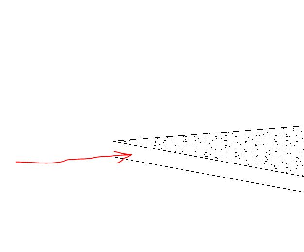

I have an 8" thick roof slab (concrete) and the surface, roof plan view, shows the poche just fine.
however in elevation views, the side of the slab will not show the poche...i am sort of wondering if it is showing but the poche scale is so large that it simply is not appearing.  But plan and section show a normal scale that should appear just fine.
having the same issue with a mass i created...neither show the concrete poche in elevation view.
thanks for your time in advnace...

Sides of objects are not poched by default. So in plan you are seeing the top pattern, and in section you are seeing the cut pattern.
If you want it to be poched in elevation use the "paint" tool.
