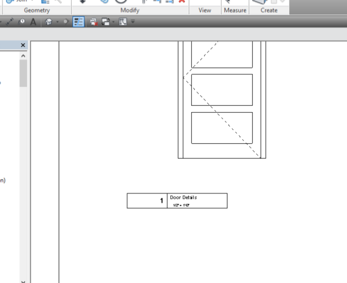

I am trying to create a View Title with adjustable grips for the surrounding linework so that I can pull the box out to the right to match the length of each view similar to  a line based family. Is there a way to accomplish this? I tried inserting a line based detail into the family in creation but it was not complatable in the view title family template.
Fri, Jul 31, 2015 at 11:11:37 AM | Creating a New View Title that is adjustable in the project
We have never been able to do what you want with view titles.   The only adjustable one was the built in line title.  (I don't believe this has changed in 2016 either)
We build multiple sized View Titles based on Types.
Fri, Jul 31, 2015 at 11:17:36 AM | Creating a New View Title that is adjustable in the project
coastalclimbing
Joined: Sun, Nov 23, 2014
0 Posts
5 Stars: 1 Votes
Do you know if there is a way to modify the extension line so it is a box instead of a line?
Fri, Jul 31, 2015 at 11:32:20 AM | Creating a New View Title that is adjustable in the project
No way that I have ever seen here on RC.
