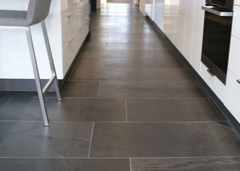

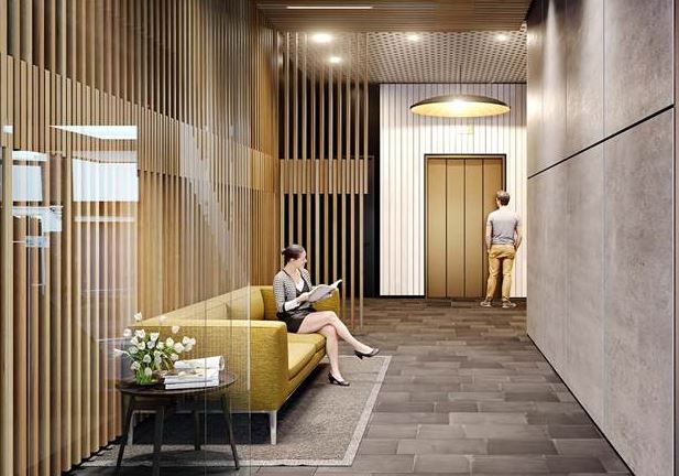

Ive been having a few issues trying to create a .pat file which shows our proposed tile layouts. I always struggle to get these .PAT files to work correctly.
If anyone could help, it would be much appreciated. They need to be model patterns (not drafting patterns).
  • The first pattern uses 2 tile sizes of 400x195mm & 195x195mm. The layout is as per the image attached titled Screenshot1 and the detail lines in the attached Revit 2015 file (Lobby Flooring Detail Lines).
  • The second pattern uses 1 tile size (either 605x400mm OR 810x400mm) with a stretcher bond type layout. Layout is as per attached image titled Screenshot2.

Attached is a pattern exported from Revit that was created by HatchKit directly from the pattern template contained in the family file originally posted.
For the time being it's much easier if the arrangement is presented in a project file rather than in a family file so if you are still baffled please post the second as a .rvt  Smile
