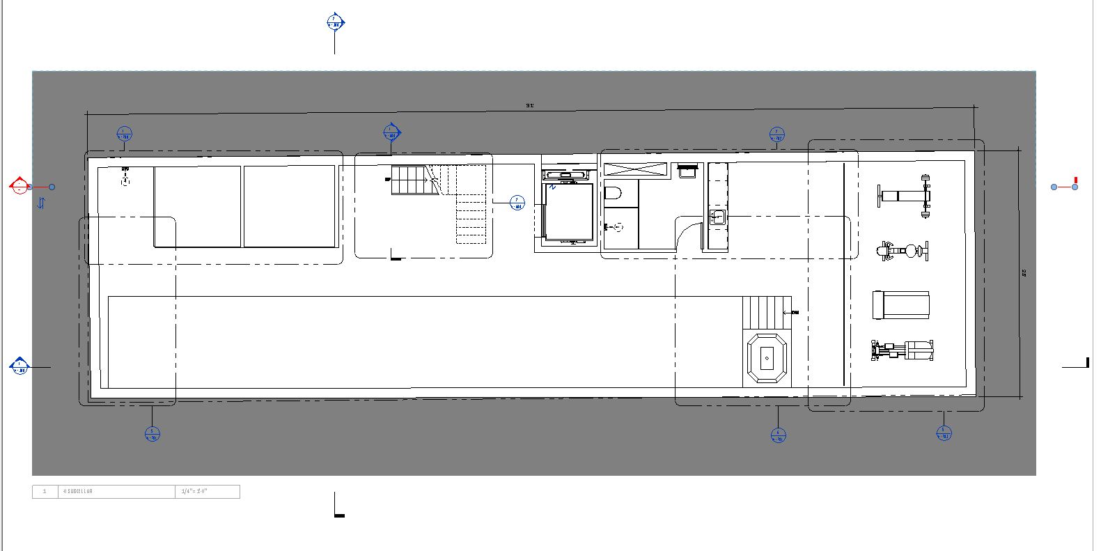

Hi All,
Does anyone know how to make the section marker the same across multiple plans?  Our office graphic standard is to break the symbol in the middle such that just the head and tail are visible on either side of the plan (see attached screen shot), and it would be really great to not have to manually adjust each section in each plan - similar to how you can make grid lines the same by using "propgate extents".  Is there an equivalent for section graphics?
Thanks!
Mon, Jul 27, 2015 at 11:23:08 AM | Consistent section tag graphic across many plans
I don't see a way to do this because I think this is only a view specific modification.
I can suggest a work-around but it is a pain......
  1. Cut your original section short - let's say just the left side.... non of the building.   Use a section cut with no tail.  Drag the view cut limits manually to include the whole building.
  2. Now do another section using reference other view (first section) and cut it on the right - again outside the building with no head - only the tail.
NOT A GOOD SOLUTION AT ALL ....
