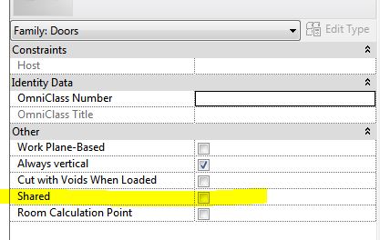

With shared nested family, only instance parameters can be transferred. Either, change parameters to instance (you can change them back to type in the parent family if needed) or uncheck shared in panel_doorp file before loading to the parent family.

Yes it worked, only because the 'upper frame' family is not shared.
