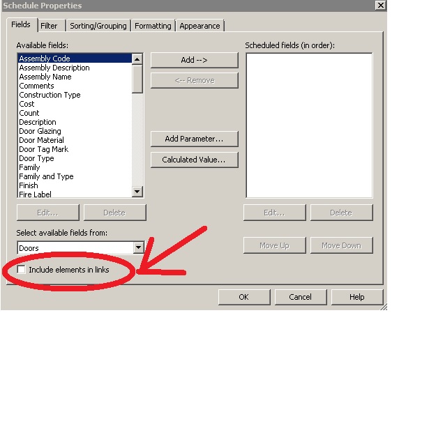

Let's start with the easy one first - Linked files and schedules.  Look at the image beloew - did you ever notice what I have pointed to?  What you do need to understand here though, is that all data has to be filled out in the file where the element resides.  That can be prolemtic depending on your process.
