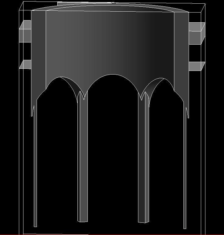

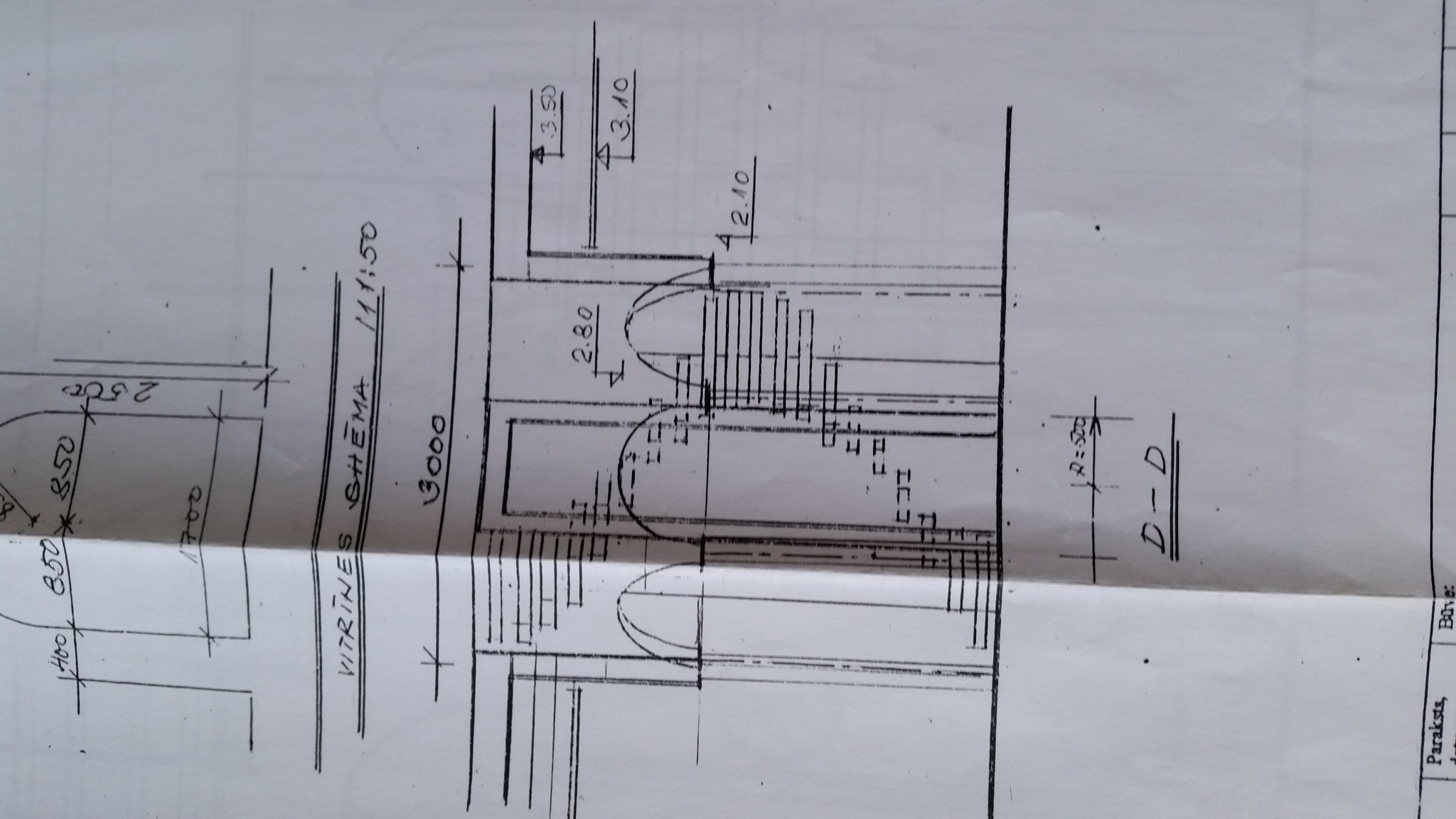

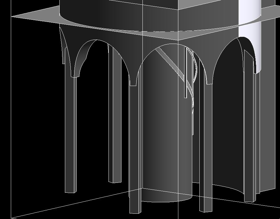

Hello.
I can't figure out a way to create an arch for a circular wall (see attached pictures). I created a window opening, but it cuts the wall in a straight way. I also tried using mass, but both in-place and standart way it does not allow to use the circular face as a reference. Is there any way it can be done in Revit?
Thank you in advance.

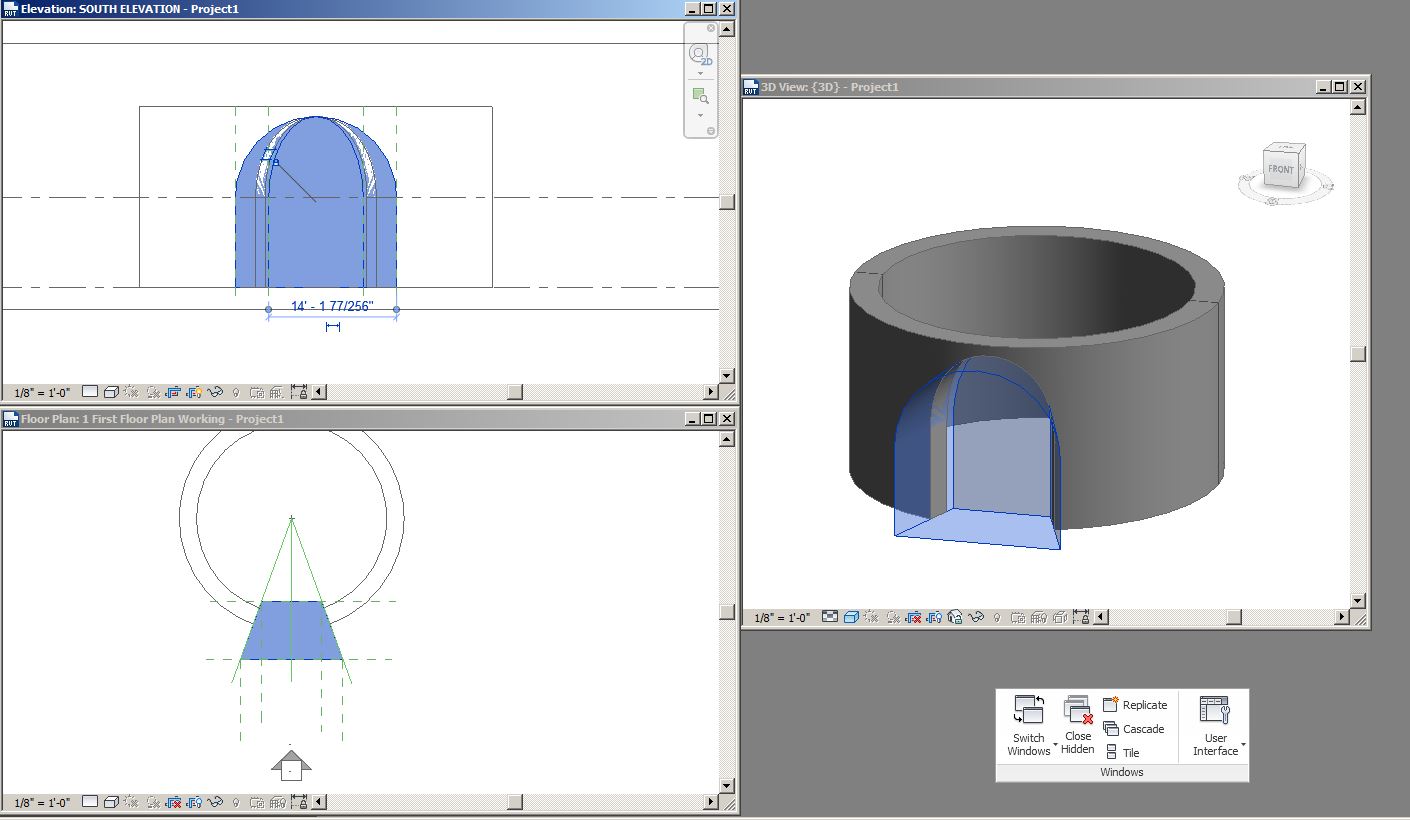

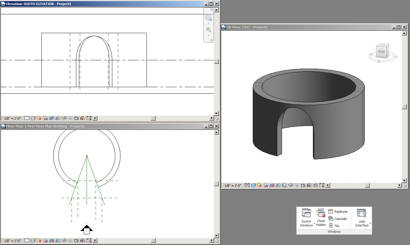

Use an in-place void.

Worked perfectly. Thank you very much!
