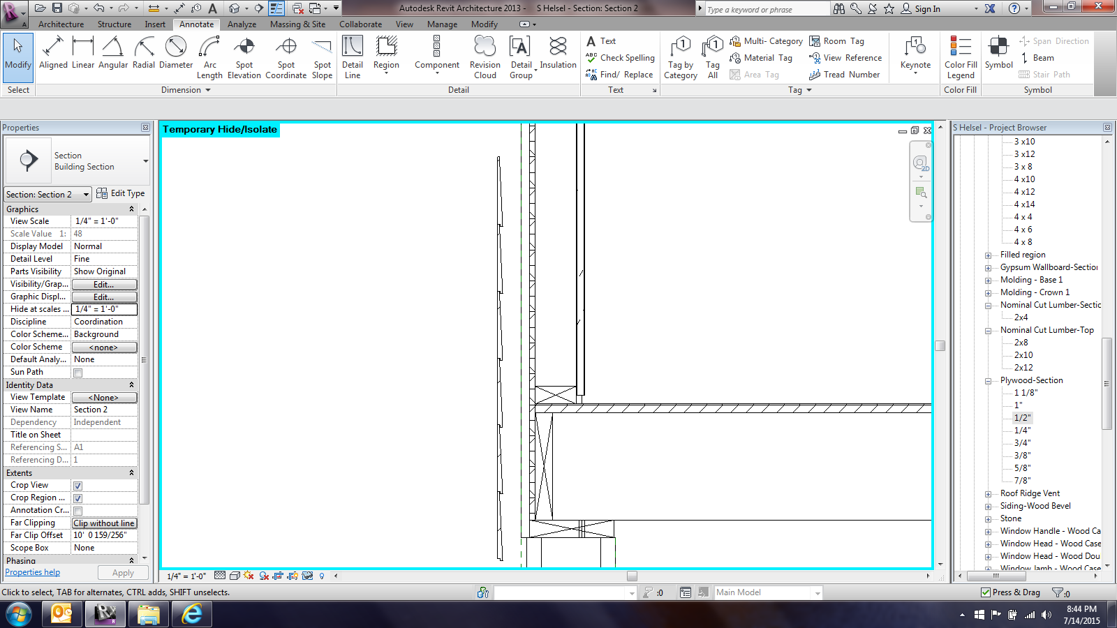

Anyone know how to flip the face of the default repeating lap siding?
I hate to think I need to redo my section from the other direction
Thanks,
Gary

Have you tried mirror tool? You can also hit the space bar to flip it before you make a second (final) click when placing.

yeah there is. thanks pij
and:
in family editor, can just mirror and  SAVE AS the detail item?
in your project, duplicate the type and select the new "mirrored detail item" and apply...

Yes, I merrored it and it works fine. Thanks!
