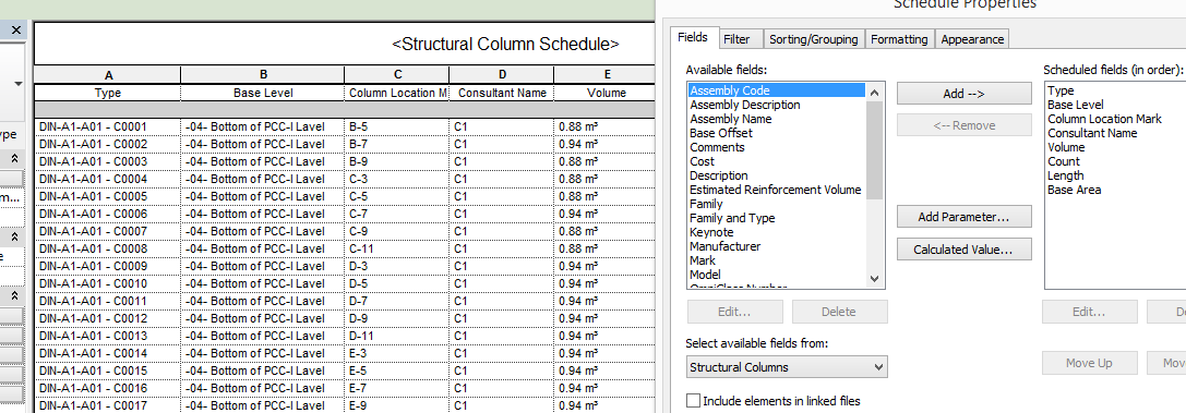

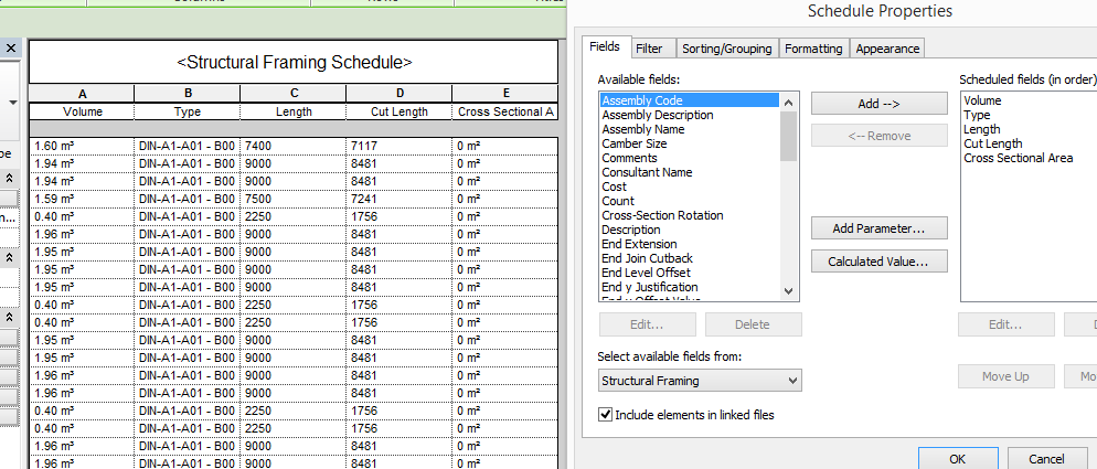

1-Existing Quantity take off module  in Revit automates location mark( Grids) for columns only. Though it is required for other elements like BEAM, Slab, Wall and Footings etc. (Civil work elements and related quantities)- Please refer attachments.
2- I want Cross Sectional Dimensions fields (e.g. LXB for Column and Beam perimeter in few cases) in schedule, which are not in field section.
Kindly Help.

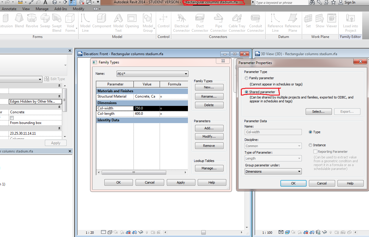

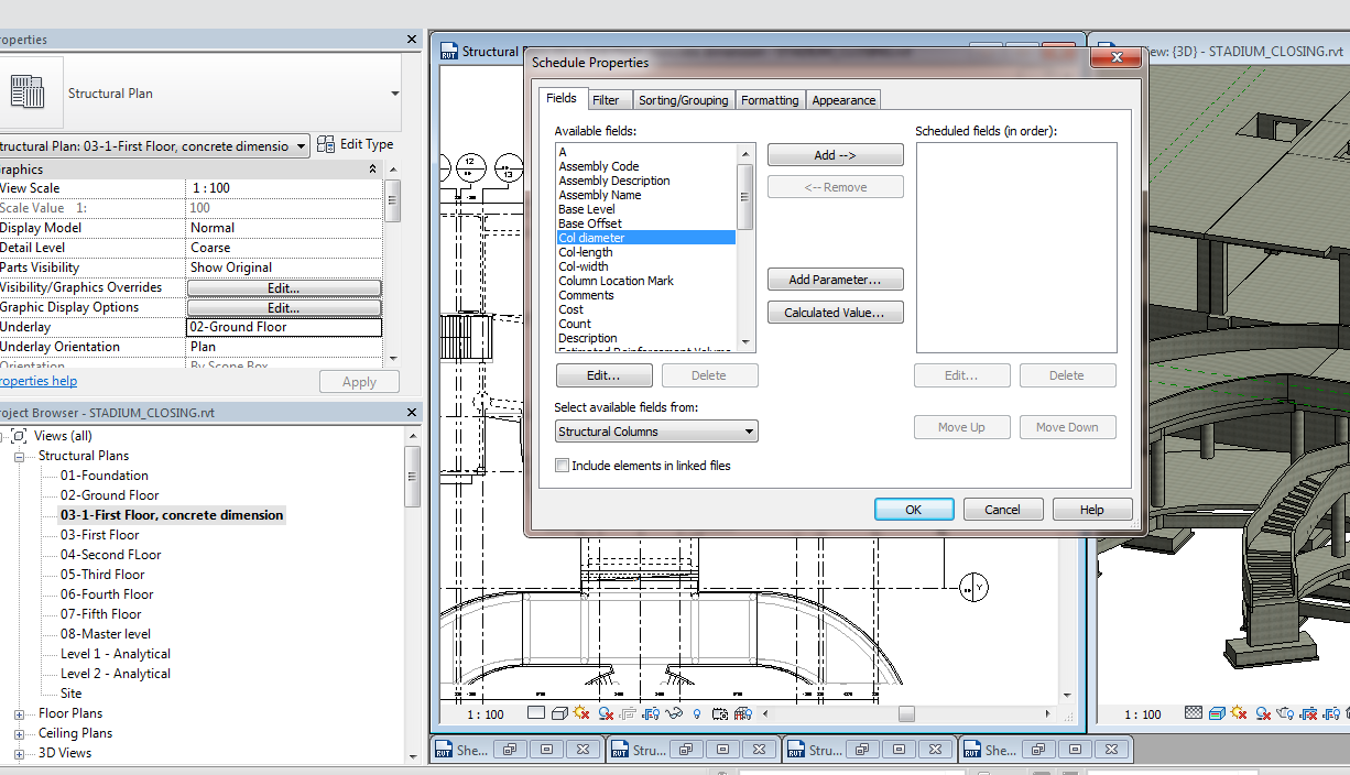

well , u need to make sure that this parameters u want to report in your schedule or sheet , that they are a (Shared parameters) , u can make this when u creating ur families entity before u start the project , or edit them by adding new (shared parameters) connecting them in a formula , to the column dimensions exsisting parameters......(check attatchment)

Thanks hussie..
Your elaborated solution helped me for the 2nd problem.
