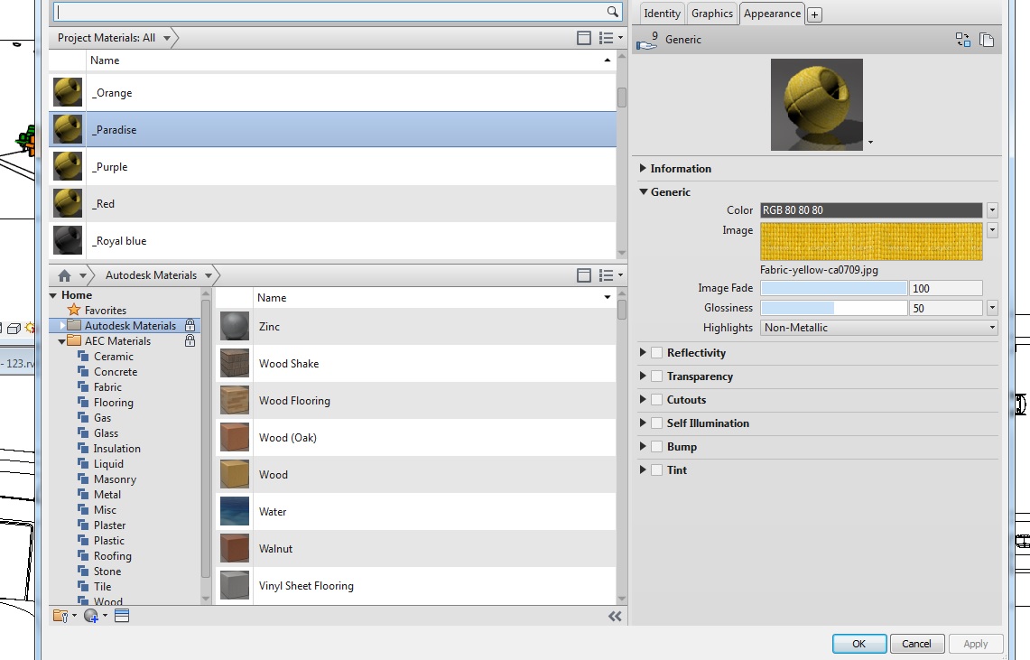

I assigned a jpeg image to a material i created and automatically scores of other materials have the same image assign to them (when they should not!). Please see image.
What did i do wrong?
I'm using revit 2015.
Please help. I'm doing an urgent rendering job.
Fri, Jul 10, 2015 at 7:30:33 AM | Assigned a jpeg image to one material and other have it too
As of 2013, Revit materials have assets that can be assigned to multiple materials.
Read this article to understand this system.
