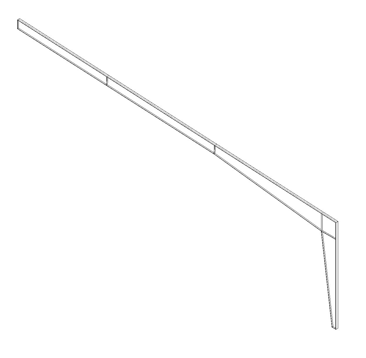

Hi All,
i am looking for either some help, or if someone is willing to model this (and i will pay them).

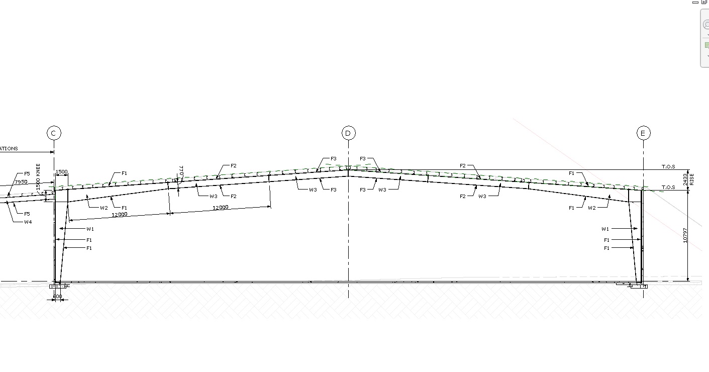

i need to model up a portal frame of something we call "steltech" in NZ. it is essentially a tapered leg (straight on the outside) and then a series of tapered rafters.
the span of this is 60m, knee depth 1550mm. I have a 2d cad plan of the layout and info on all of the flanges and webs. I have tried setting up a parametric family with sweeps and extrusions, but to be honest my experience in this type of family creation is limited.
attached a screen grab of a simplistic one the architect has generated (i have tried editing / getting inspiration from theirs, no luck).
i would like to able to re-use the family for other sheds etc, so need to able to adjust knee depth, span, height, pitch etc.
thanks in advance,
Mark

Thanks for the message and link, have downloaded and theres certainly some themes in there i will try and use to model the frame.
my offer still stands if anyone thinks they could model this..
