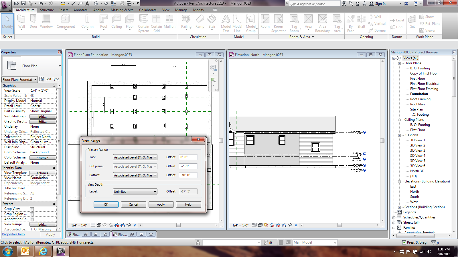

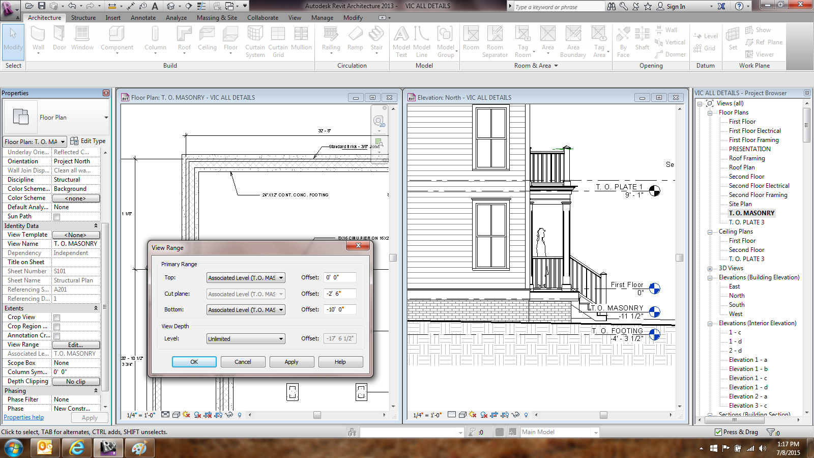

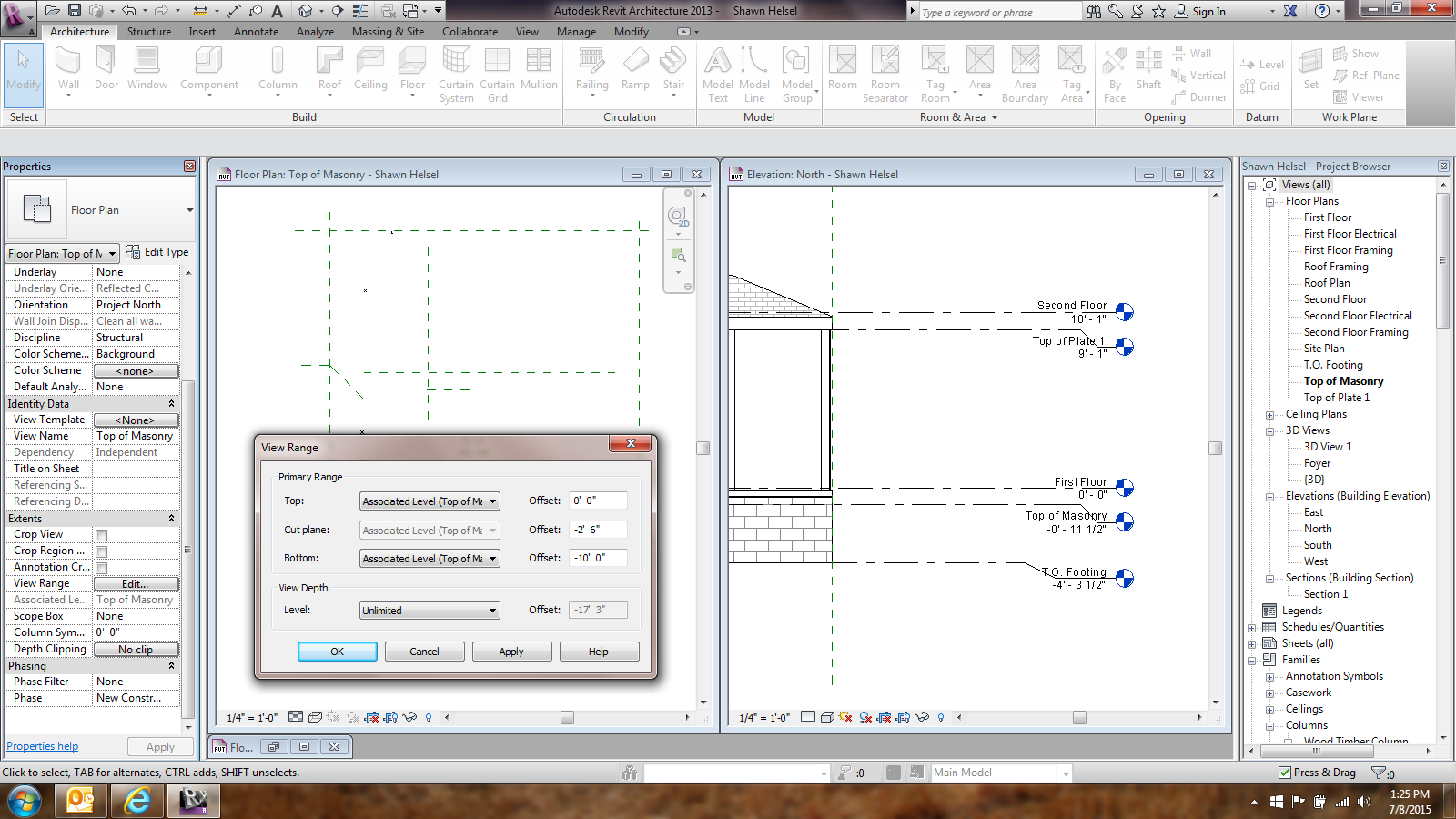

OK, I have attached 3 screenshots.
Can someone tell me why with the VICTORIAN, that the Foundation (Top of masonry) (That I was taught in Revit training class) shows all the details right down to the surface of the footing, but in the oter two, Addition only shows the piers and footing but no brick/block masonry wall. And the third Craftsman only shows the reference planes?
As you can see the View Range is set the same in all 3 and the top of masonry is at the same level in all 3.
I don't believe I have fooled with VG in any of them.
Can anyone see what I am doing wrong?
Thanks
Gary
Wed, Jul 8, 2015 at 12:58:08 PM | Tutoring using Go to meeting, or another type
You are copying views - don't do that!  Unless you really know what you are doing, always create your plans from the View/ Plan dropdown.
I see that all of these views may actually be RCP's because the possible underlay orientation is set to RCP.  In normal Plan views, this will be set to Plan.

Wed, Jul 8, 2015 at 3:17:10 PM | Tutoring using Go to meeting, or another type
RCP is Reflected Ceiling Plan.
All of your level indicators are Blue which indicates they have associated plans with them.  You probably initially created the level and allowed Revit to automatically create a floor plan and a RCP for each level.   There is nothing wrong with that but obviously, you don't need a RCP for a footing level.  I usually say NO except for main lfloor levels.
Do this.  Goto the View Tab / Plan Views and pick floor plan.   Uncheck the 'Do not duplicate...' box, then pick your top of masonry level.  Goto that view and set the view and cut ranges.  (NOTE: The underlay orientation will say PLAN).  Make sure your VG is set like your good plan and let's see what you get.

Your discipline is set to Structural. If your walls are not structural, they will not show. Change the discipline to Coordination, or make sure your walls are structural.

WOW, Changing the foundation wall to Structural in the properties took care of it!
I never understood the difference, now I will always pick Strucural when promped?
Had never fooled with the Discipline before. Will now try it when problems arise.
