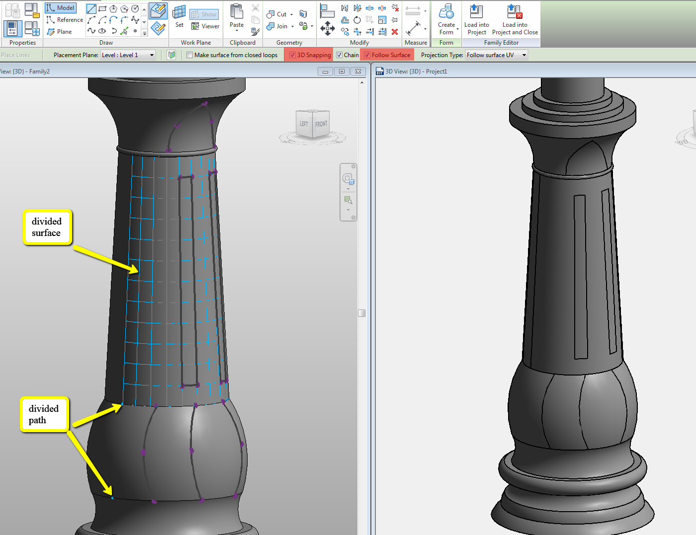

I'm a seasoned homebuilder and Revit novice in the New Orleans area.  I'm using Revit Architecture 2014 and I wanted a cast aluminum column for one of my designs and could not find one anywhere, so I created one that came out quite nicely.  The only problem that I can't seem to figure out is how to draw model lines representing details such as fluting in the curved and tapered faces.  If anyone would like to coach me a bit, open the attachment and you will notice model lines in the lower portion of the column visible in front elevation view...the problem is that is the only view I can see them.  I'm guessing this is because the lines are not drawn in the correct plane?  But I can't figure out how to create a plane around these shapes.

It would be nice to be able to pick any surface and draw on it in the project, unfortunately that option is available in mass environment only. If you’re satisfied with just showing lines (vs. real geometry/shape), you can load your column to the mass family and use model lines to draw on any surface with 3D Snapping and Follow Surface options checked. Divided Surface and Path tools will help to be more accurate.

Nice!  That works great; thank you so much.
