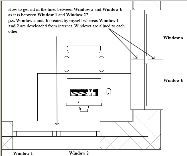

Hi,
Im creating a window, and when I load it to project, and place two widows aligned to each other,
there is a line between two windows. I need a clear sillSmile See attachment pls
Mon, Jun 15, 2015 at 1:03:07 PM | windows (family) problem. Print Scrn attached.
You can use the linework tool to remove that line.
You can create a new family with a nested family in it and the sill adjusted accordingly.
