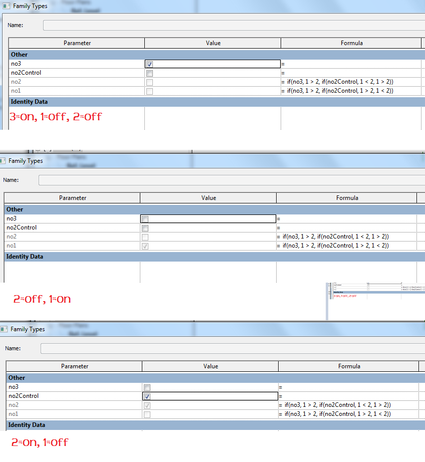

Hi.
I’m relatively new to the formula section of a family.
I want to make a family with the following options:
01: Not 02 02: 03:
I want to be able to switch between 01 and 02 with the formula, that’s the easy part. Secondly I want to turn both 01 and 02 off with the 03.
So far I’m not able to do it. I tried multiple formula’s.
Does anyone have an answer?
Thanks in advance.
Greetings from the Netherlands

Thanks a lot! I think i got it to work!

This is the final result!
