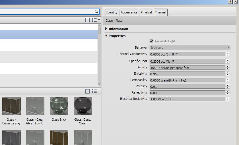

Why?  See attached.

because then I would have to duplicate the number of glazing elemnets in the model and apply yes/no parameters to them. These glazings will have to be parametric constrained and to apply these contraints to all of the glazing types will take extreme amount of work of duplication. In reality the client does not need to see the change of glazing materials. Plus the additonal hidden glazing types will increase the already large file size as well...
Wed, Jun 10, 2015 at 3:29:11 PM | How to control a text parameter with yes/no parameters?
It's a material change.....   Very very small.  And it will schedule!

My point is to allow the user to have the option to choose from 4 types of glazings.. not let them change the glazing material themselves.
Wed, Jun 10, 2015 at 3:50:21 PM | How to control a text parameter with yes/no parameters?
Use a Type Catalog: http://help.autodesk.com/view/RVT/2014/ENU/?guid=GUID-FFA71D72-D4C5-416D-BF65-1757657C3CE9
