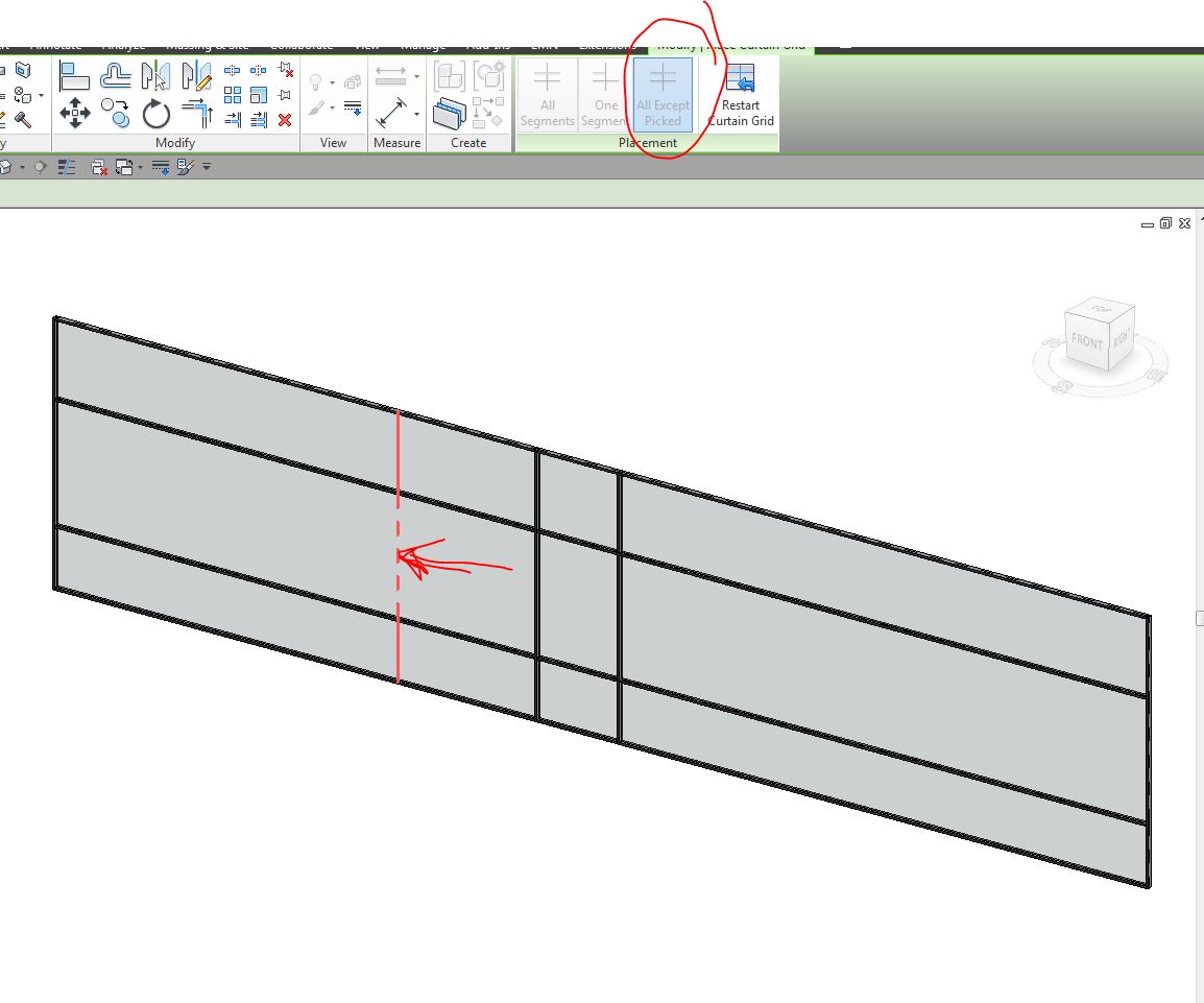

Hi I have the same problem with this curtain wall please Help me ..
what happens is that by placing the horizontally .. mullion separates the panel..y need to be continued as shown in the second image

A couple of things here:
A) if your curtain wall has pre-determined spacing, then you can click on the curtain GRID.  Not mullion, not panel. and then the ribbon up at the top will give you the option to "remove" a grid.
B) when you go to make a curtain wall and you are creating custom spaces, then when you make your curtain wall as a single panel, use the add grid, then choose "all but selected" and create your spacing and add staggers as required.
Is this what you were asking for?

hi i dont explain very well.
the problem is when i create a mullion in curtain wall, its separete the panel. and ineed to be continuos..
the second image is bellow
