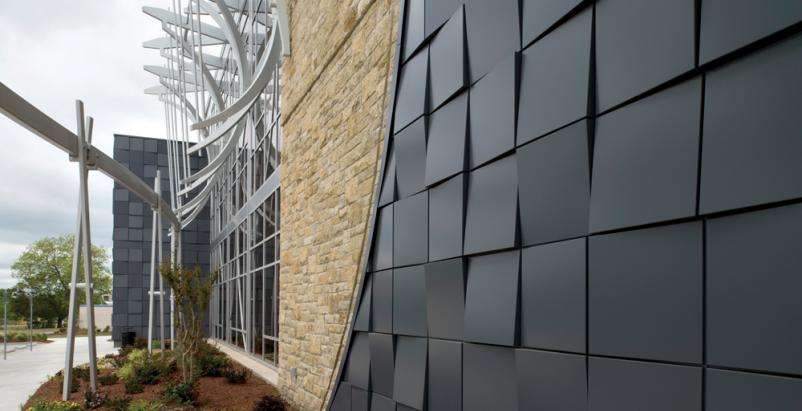

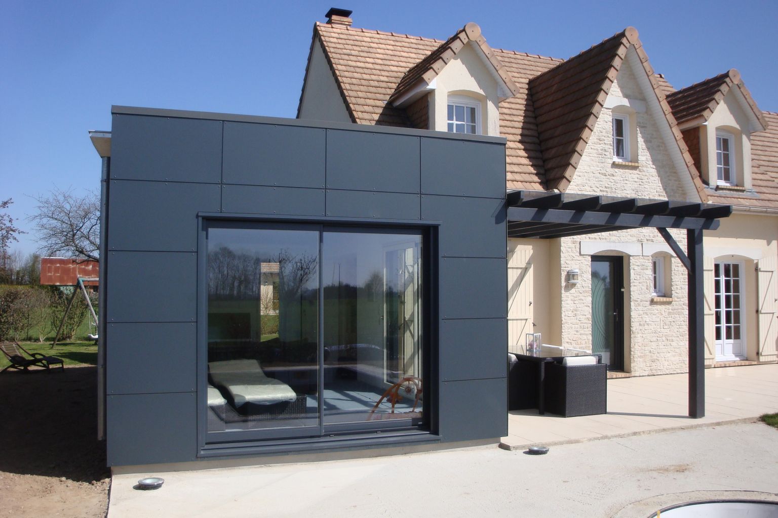

Id like to create these two types of wall panels..How do I do it?

I would use a curtain wall. Set the curtain wall perimeter to suit your needs. Set the grids to suit your panel spacing. Create a solid panel in the material thickness, buildup and colours that you need and replace all the curtain wall glass panels with it. Create a mullion that is recessed from the external face and has a rear frame amd silicon joint. Job done.
