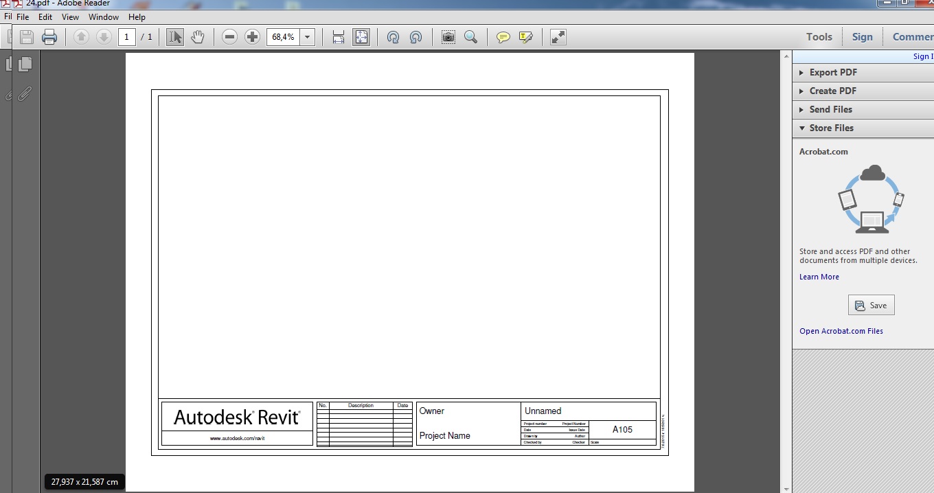

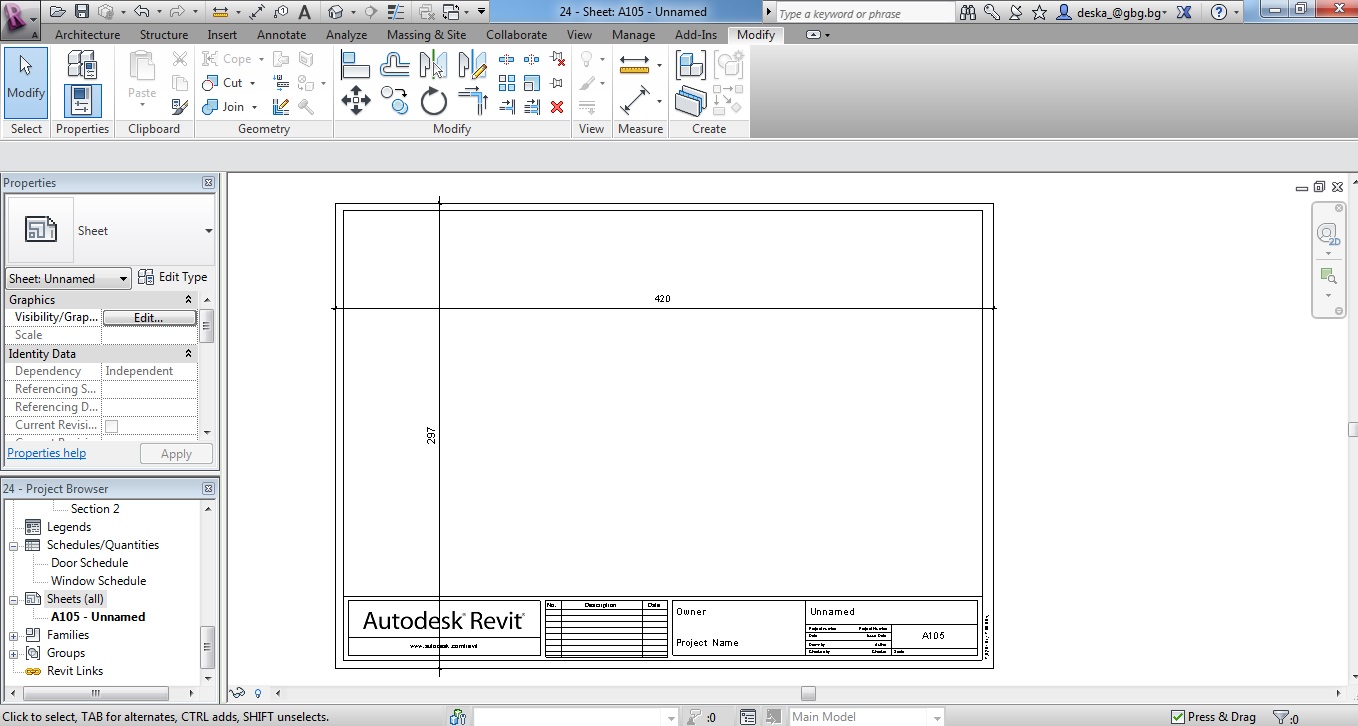

I have a problem with the printing of my file. I didn't have it until now and i can't find why and where is the problem. I use A3 metric titleblock, but when i print it ( via Cute Pdf or Microsoft Document Writer or Solid pdf converter) the drawing is scaled and its not with the real size (297x420). Please help.. Thank you

Check your print range is current window, check in print setup your size is A3, check in print setup that youzoom is 100%, check in print setup that your paper placement is center, measure your sheet to check that it is actually A3.
