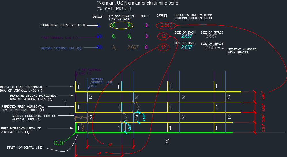

or better still you can learn to write your own pat files (see attached description)
