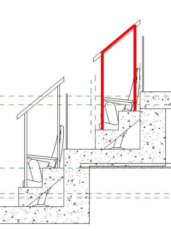

Hello,
I am using Revit 2014.  I am trying to edit a rail extension.  I have placed these raillings on a host and offset the balusters to be 3" away from the face of the treads.  I need the handrail to stop at the balusters.  If I edit the path of the rail to start and end where I need it to, it changes the slope of the rail.  How can I get my rail to look like the attached?  I'm sure this is an easy fix but I can't get it to work.
Thanks.
Fri, Jun 5, 2015 at 10:13:55 AM | Railing Extensions
You have only two ballusters - correct?   Define as end posts instead.  To have the handrail end at the outside face of the post instead of the middle, change the post space + or - as appropriate.

Yes I only have two balusters.  How do I define them as end posts?  Thanks!
