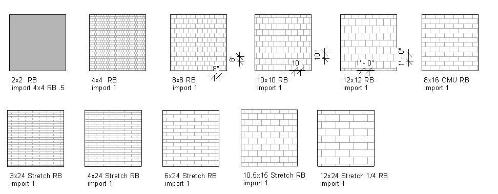

I personally think that names only solve part of the issue.  I think the best way to laod and use pat files is from a resource project.  We have a resource project that is just fill patters.   Each pattern is used in a filled region that is named and shown in a view along with the recommended load scale.   To use, we open the resource project in the same Revit session as our project, open the view with the regions, pick one and copy it to clipboard.  Then pasting that in any view give us both the filled region and the pattern. ...of course you can then just delete that region from that view.  Partial view of our ref project.
