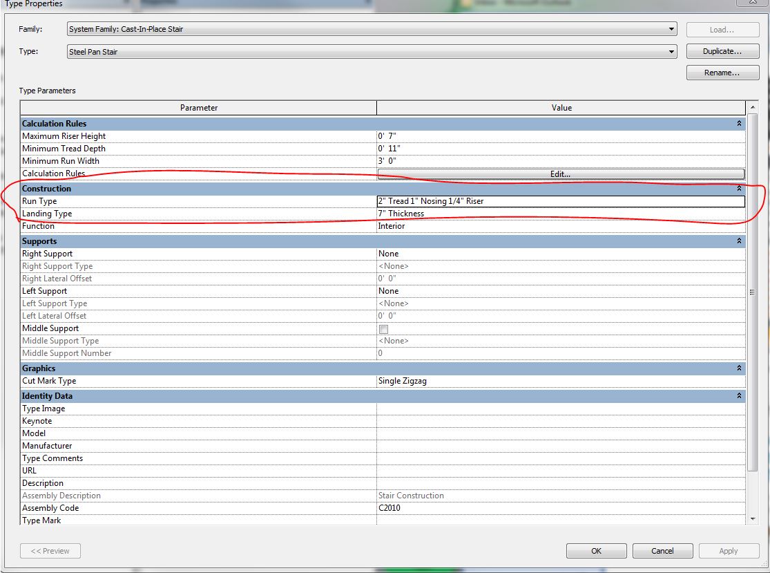

Is there a way to apply carpet or vinyl materials to treads, risers and landings?
Tue, Jun 2, 2015 at 6:54:44 AM | Stair finishes
teafoe5
teafoe5 Avatar
Joined: Fri, Nov 12, 2010
1749 Posts
4 Stars: 47 Votes

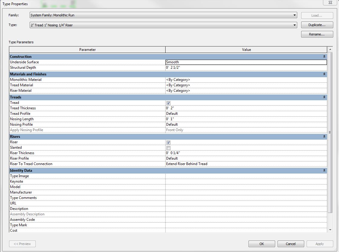

Click on your Stair>Edit Type then under Construction click on your Run Type and you can change the materials in there.
