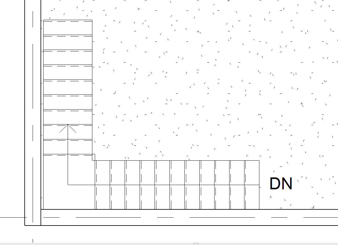

I would like the stair path to extend the full length of the stair. it starts at the fisrt step and seems to end at where the implied breakline would be. is there a way to have the end (arrow head) go to the last step?

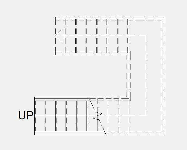

1. select arrow->edit type->distance to cut mark: 0->show arrowhead to cut mark: uncheck.
2. vg->annotation categories tab->stair path (expand)->check <above> up arrows-> (optional) projection lines override->pattern->solid

I followed your steps and nothing changed. I am using "Automatic Up/Down Direction" stair path. I am attaching a screen shot of the stair thatI am having trouble with

It was for the stair going up. I don’t think it is possible to make it for the stair going down other than using a text tool. I’d love to be proven wrong though.
